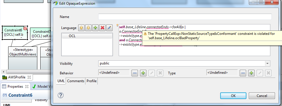

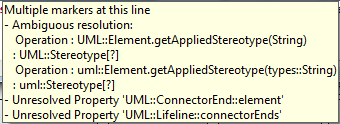

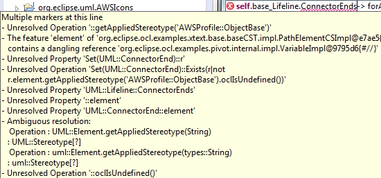

Re: OCL constraints on stereotypes [message #1434060 is a reply to message #1434030] Mon, 29 September 2014 11:55 Go to previous messageGo to next message
Thank you Camille..
But unfortunately, nothing changed..
I don't know if the operation getConnectorEnds() and the property connectorEnd work with Lifelines and messages (Sequence diagram).
self.base_Lifeline.getConnectorEnds()-> forAll (o | o.connectorEnd->exists (r|not r.element.getAppliedStereotype('AWSProfile::ObjectBase').oclIsUndefined() )and
o.connectorEnd ->exists (r|not r.element.getAppliedStereotype('AWSProfile::ObjectMultiviews').oclIsUndefined()))
I saw in a paper "self.send.sendMessageEnd", but I don't know if it's the correct syntax or not.
  • Attachment: 2.png
    (Size: 6.56KB, Downloaded 225 times)
  • Attachment: 1.png
    (Size: 19.92KB, Downloaded 184 times)

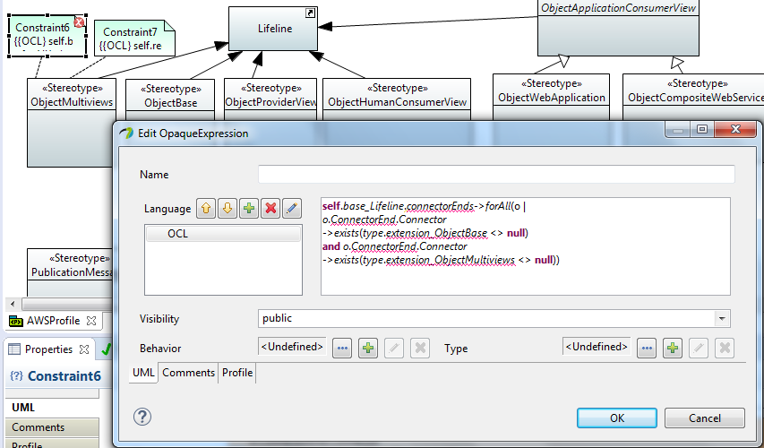

Re: OCL constraints on stereotypes [message #1434577 is a reply to message #1434060] Tue, 30 September 2014 05:25 Go to previous messageGo to next message
Hi Camille,
I moved to Eclipse Luna, Papyrus v1.0.0 20140611 and OCL 5.0.2
I put this constraint but the parser didn't accept it:
self.base_Lifeline.connectorEnds->forAll(o |
o.ConnectorEnd.Connector
->exists(type.extension_ObjectBase <> null)
and o.ConnectorEnd.Connector
->exists(type.extension_ObjectMultiviews <> null))
I Still don't know what is the right syntax Sad
Could you help me please...
  • Attachment: error1.png
    (Size: 71.68KB, Downloaded 220 times)
  • Attachment: error2.png
    (Size: 80.98KB, Downloaded 191 times)
Re: OCL constraints on stereotypes [message #1434804 is a reply to message #1434577] Tue, 30 September 2014 12:19 Go to previous messageGo to next message
Hi, Walid,
The Lifeline metaclass has no 'connectorEnds' property. It has a
'represents' property of type ConnectableElement that has an 'end'
property (note the singular).
The ConnectorEnd metaclass has no 'ConnectorEnd' property nor
'Connector'. Unfortunately, the UML metamodel completely forgot to
define an opposite of the Connector::end property, so you have to
navigate awkwardly through the end's owner.
How does the following work for you?

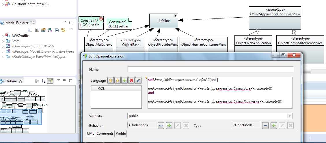

self.base_Lifeline.represents.end->forAll(end |
end.owner.oclAsType(Connector)->exists(type.extension_ObjectBase->notEmpty())
and
end.owner.oclAsType(Connector)->exists(type.extension_ObjectMultiviews->notEmpty()))
This says that, if the lifeline's represented connectable element is
associated with any connector ends, then the connector owning every
associated end must be typed by an association that has both the
<<ObjectBase>> and <<ObjectMultiviews>> stereotype applied. Is that
the constraint that you want to express?
HTH,
Christian

Hi Christian,
Thank you for reply...
I have a profile that contains stereotypes which extend the meta-class "Lifeline". These stereotypes are "ObjectBase", "ObjectMultiviews", "ObjectProviderView" and "ObjectHumanConsumer".
The constraint (which must be created in my profile) tells that :an "ObjectMultiviews" Lifeline could only send messages to another "ObjectMultiviews" Lifeline or to an "ObjectBase" Lifeline.
So, if for example, an "ObjectMultiviews" Lifeline sends a message to an "ObjectProviderView" Lifeline, an errors must be occured when I validate a model (on which my profile is applied).
Any solution please?
Thank you for your collaboration...

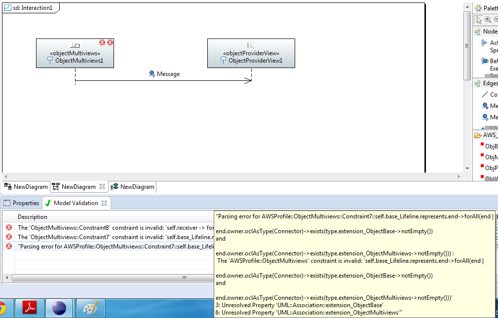

Re: OCL constraints on stereotypes [message #1435614 is a reply to message #1435583] Wed, 01 October 2014 15:03 Go to previous messageGo to next message
All right, thank you Christian
Well, the parser didn't accept "extension_ObjectBase" and "extension_ObjectMultiviews" ! (Unresolved Property 'UML::Association::extension_ObjectBase')
I think because the stereotype "ObjectBase" extends Lifeline Meta-Class not Association Meta-Class. (I hope that you understand what I mean)
Any suggestion??
  • Attachment: error.png
    (Size: 99.30KB, Downloaded 176 times)
  • Attachment: workspace_Luna.rar
    (Size: 5.60MB, Downloaded 172 times)
    (Size: 78.34KB, Downloaded 173 times)
