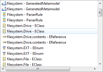

Alternatively: if you press Crtl+Shift+F3 and search for Model Elements of Type FIle and Folder(Runtime WS) what are the names displayed for your stuff.
Re: Check duplicate name in the same Scop [message #1049224 is a reply to message #1049217] Thu, 25 April 2013 10:27 Go to previous messageGo to next message
Hi Christian,
Sorry,QualifiedNamePrivider in the AstractFileSystemruntimeModule.
and My model Elements for file in the attachment.SimpleNameProvider used.

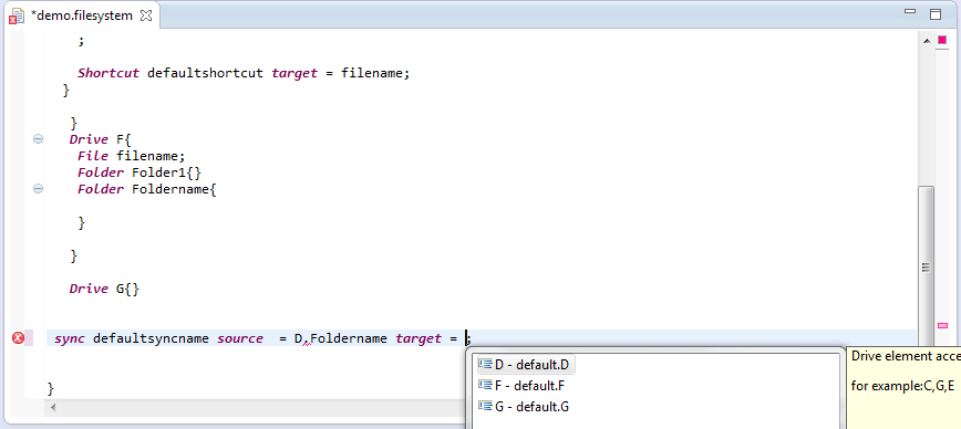

Re: Check duplicate name in the same Scop [message #1050911 is a reply to message #1049975] Sat, 27 April 2013 20:11 Go to previous messageGo to next message
Hi Christian,
I use Qualifiednameprovider but I have a problem with crossreference .'sync' name=ID 'source' '=' source =[SyncElement|ID] 'target' '=' target =[SyncElement|ID] ';'
When I enter ctrl-space "after source =" get Drive names (such as D,C,E). my problem is :don t get all of object (File ,Folder,Drive names don t get )
BUT,I added Qualifiedname in the grammar,such as
'sync' name=ID 'source' '=' source =[SyncElement|@ualifiedname] 'target' '=' target =[SyncElement|ID] ';'
Qualifiedname :
ID
'target' '=' target =[SyncElement|ID] : get onlly Drive names For target
source =[SyncElement|@ualifiedname] :get all File Drive and Folder names with "." such as D.folder1 ->I do not wanted this
When I reach Folder and File.but get D.file1 Sad I do not wanted use for Qualifiedname : ID('.'ID)*
I attached program screenshot.
How can I solved Crossreference problem?
