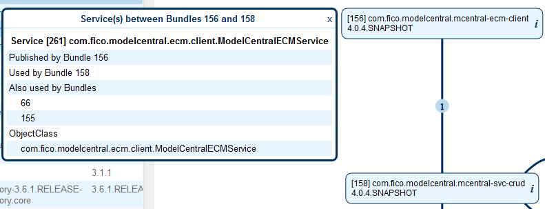

Re: Using the Config admin service [message #1044826 is a reply to message #1044610] Fri, 19 April 2013 07:40 Go to previous messageGo to next message
Yes it is, and properly resolved by another service which is able to invoke it... at which point everything fails because the called service has not been configured.
I have been trying to debug the ConfigAdmin code, got lost in the maze of eclipse plugins... a Maven repo of the plugin versions used by Virgo would be very nice...
Anyway, still no clue as to what is happening here.
Franck
