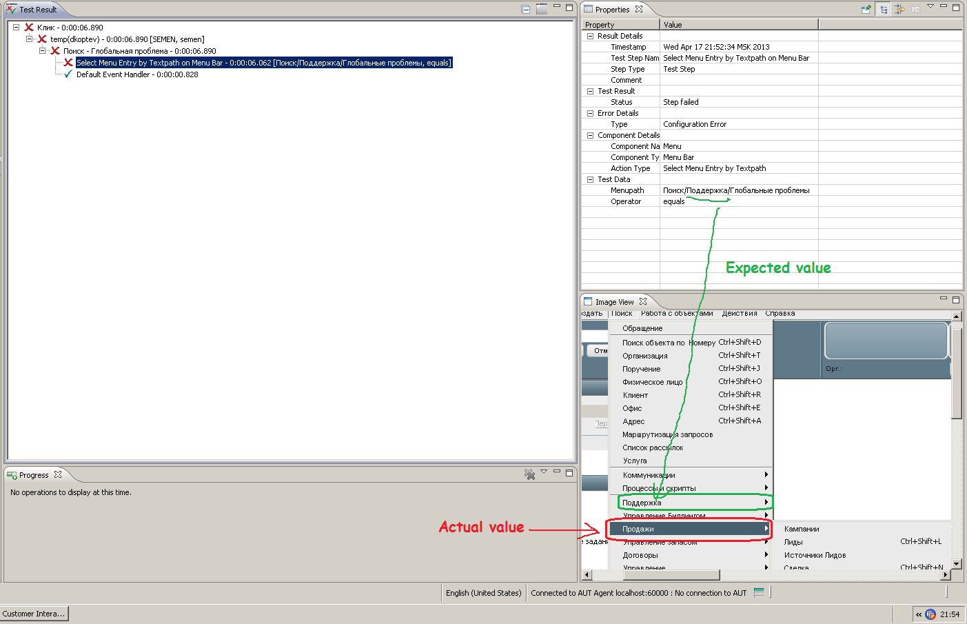

Half of our test uses menu bar. And if menu-entry should be clicked in 3 levels deep jubula2 will click in wrong way.
For example:
Test step should click on Menupath 'Поиск'/'Поддержка'/'Глобальные проблемы'
It clicks on 'Поиск'
Then it moves mouse on the menu list to point 'Продажи' instead of 'Поддержка'.
And of course it didn't find 'Глобальные проблемы' inside.
See the screen with error in attach.
I have tried to reproduce it on DVDtool from the examples folder, but it worked correct. If it is needed, Tomorrow i will try to reproduce this bug on any other example app.

Re: Select menu by text-path doesn't work on jubula2. [message #1047649 is a reply to message #1046865] Tue, 23 April 2013 09:30 Go to previous messageGo to next message
Hi Danila,
We've been able to reproduce this error internally now. We believe that it has to do with dynamic menus -> this would explain why sometimes the wrong entry is selected, and why sometimes nothing is selected.
Can you confirm whether the menu you're using has extra items that are added / removed depending on the context?
I have entered a very high priority bug for this:
https://bugs.eclipse.org/bugs/show_bug.cgi?id=406318
The team will look at it immediately - all other updates will be on the bug directly.
Thanks for your assistance in identifying this.
Alex
