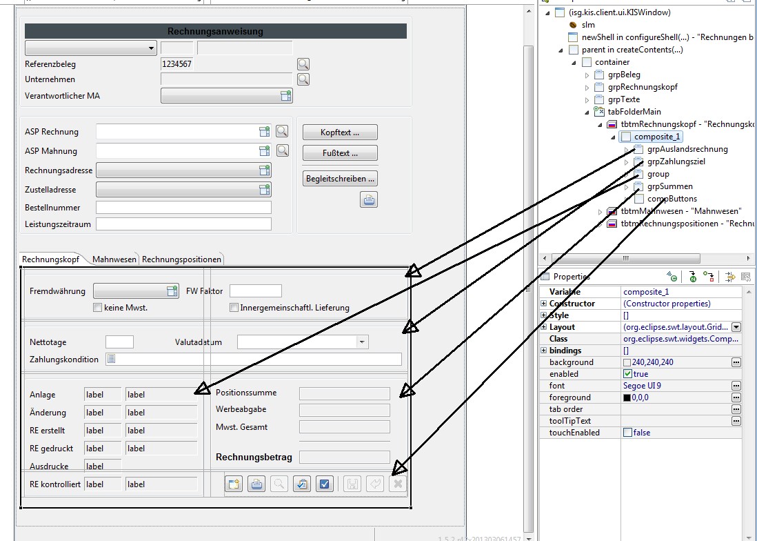

I use a workspace with Juno Java EE IDE 1.5.1.20121004-1506 and the above version of WindowsBuilder. I open my workspace and a JFace Application window with the designer - it shows up like in BeforeJunoSP2.jpg.

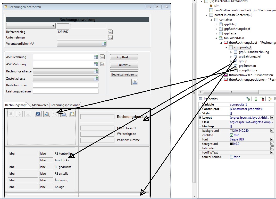

I copied the complete juno installation and updated to 1.5.2.20130211-1820. No other plugin is updated! When I open the same Workspace and java class like before, it shows up like in AftfterJunoSP2.jpg.

Here is the testcase. Simply load the project with Juno 4.2 SP1 and then with Juno 4.2 SP2 and the latest WB version from the market. You will see the affect thats also shown in my sreenshots. It seems that the parsing starts with the last element in the grid an places it in the first cell.

We can reproduce it under Windows but not OSX. It appears to be an issue with CTabFolders rather than GridLayout and caused by some recent change to SWT (in Juno SP2). Other layouts like FillLayout are similarly affected when contained within a CTabFolder. Nothing in this area of WB has changed in quite awhile, so we have not been able to identify the underlying issue.
Do you see this happen anywhere outside the context of a CTabFolder? if so, please send us an additional test case. If not, we will focus on recent changes made to CTabFolder that might cause this.
Re: GridLayout Problems after Juno SP2 Update [message #1047693 is a reply to message #1047569] Tue, 23 April 2013 10:27 Go to previous message
I checked a couple of classes in my project. All problems are connected to CTabFolders but not all CTabFolders have this problem ! Some are completely OK some only affect one subwidget. For example there is a CTabItem/composite with Formlayout containing 7 Groups with GridLayout. Only one of these groups gets destroyed (=parsed in the wrong direction). Every time the code gets parsed again (returning from another CTabItem) the layout gets worse.
