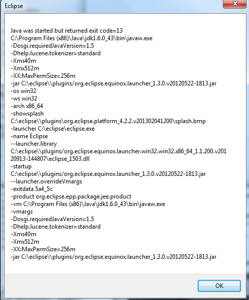

hello,
today i tried to instal eclipse.
i got java 64bit installed + eclipse
i changed the ini file:
placed
-vm
C:\Program Files (x86)\Java\jdk1.6.0_43\javaw.exe
where it has to be
but when i try to run eclipse it says error 13
what do i have to do now?
(look attachment for picture of error)
index.php/fa/14363/0/

Re: problem with starting eclipse [message #1040676 is a reply to message #1039990] Sat, 13 April 2013 20:50 Go to previous message
On 04/13/2013 09:50 AM, timothy van litsenborg wrote:
> hello,
> placed
> -vm
> where it has to be
You didn't install a 64 bit Java. Only 32 bit java gets installed in
Program Files (x86). 64 bit would be installed in Program Files.
Oracle seems to make it difficult to actually download a 64 bit Java.
