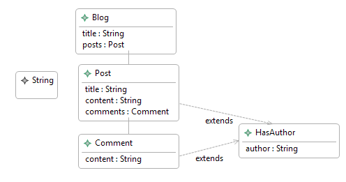

I have created the following diagram on an editor, it should be fairly self-explanatory. Links to the DataType Parts (String, in this case) are hidden but technically exist.
So if I change the name of the Datatype (i.e. String to String_), the actual properties of the elements of that Datatype are renewed, however the diagram itself doesn't refresh and still shows "[attribute] : String", not "[attribute] : String_".
However, if I close and reopen the file containing the diagram, attributes are shown correctly.
I've looked around on where I have to call what kind of refresh here, but I am kind of at a loss.
  • Attachment: model.png
    (Size: 7.42KB, Downloaded 189 times)

What I did was basically using a Value Expression for Datatypes and Features to show them in the form [Feature] : [Dtype].
Additionally, to not show the relational lines, I edited the XXXDiagramUpdater to not include those relations on refresh, that is working as designed.
However, if I update the name of a Datatype (or Entity for that matter) itself, the Expression showing the feature is not refreshed.
