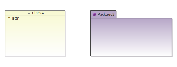

HI everybody,
Imagine the situation
I've create ecore file with two packages, as shown at attached figures (just a template).
Package1:
ClassA
Package2:
ClassB
Then, I'd like to create an attribute for ClassA, for example name it "attr", and set to it type ClassB.
But there is no ClassB in EType field for the attribute.
As I understand It is possible to select in EType fields only EDataType or EEnum.
And if I need to create an attribute of the EClass type then I required to create EReference between the classes.
So the question:
If I have two classes in different packages, how can I solve my problem and create the attribute of type, that is defined in different package.
Thanks in advance!

Re: EPackage : problem with interaction of packages [message #1039400 is a reply to message #1038689] Fri, 12 April 2013 01:50 Go to previous messageGo to next message
Igor,
Comments below.
On 11/04/2013 2:37 PM, Igor Nikiforov wrote:
> HI everybody,
> Package1:
> ClassA
> Package2:
> ClassB
> And if I need to create a attribute of the EClass type then I required to create EReference between the classes.
Yes.
> So the question:
I doubt that's what you really want. Of course you can always create
an EDataType that wraps any existing Java type, including the generated
interface from some class, but you won't be able to serialize the
attribute's value...
> Thanks in advance!
