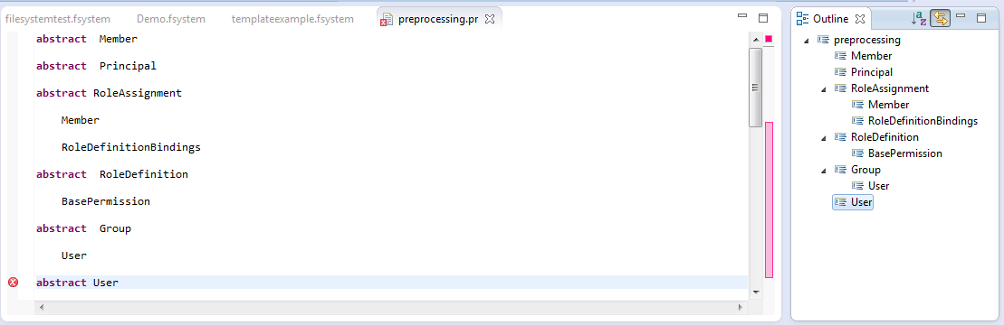

Hi All,
My grammar is below .I receive an error all time in the program.error :mismatched input '<EOF>' expecting RULE_NL. I do not solved this problem.I did several tests without success Sad Could anybody of you give me a hint? How can I solved Sad
Best Regards
Model :
elements += Elements*
Elements:
('abstract')? name =ID (':' inheritance= [Elements|ID] )? NL
( children += Child (':' compartment =[Elements|ID])? NL ( (NL children += Child NL)*)? )?
Child:
(name =ID)
terminal NL:
(('\r' '\n')? ('\t')? )

Re: mismatched input '<EOF>' expecting [message #1038107 is a reply to message #1038053] Wed, 10 April 2013 08:12 Go to previous messageGo to next message
as you should notice on running the Workflow, the language has ambiguities and thus, the terminal NL is ignored completely.
The main problem here is the terminal rule which, honestly, I can't make anything of. It's supposed to represent a new line, but can also be nothing or only a tab?
In any case, rules that could be built easily on terminals should be done with Datatype rules, as is nicely expressed here: [1].
That's just some general pointers from me, I suppose someone more experienced like Christian will deliver a more precise answer shortly.
[1] http://zarnekow.blogspot.de/2012/11/xtext-corner-6-data-types-terminals-why.html

Re: mismatched input '<EOF>' expecting [message #1038153 is a reply to message #1038129] Wed, 10 April 2013 09:23 Go to previous messageGo to next message
I can try indentation based grammar. load program and you can see outline view.I can try to providing this for NL rule.
Re: mismatched input '<EOF>' expecting [message #1038159 is a reply to message #1038153] Wed, 10 April 2013 09:32 Go to previous messageGo to next message
I don't think that your grammar approach will work for an indentation sensitive language. You may want to have a look at the following projects
http://code.google.com/p/arcas/source/browse/trunk/congen.xtext/?r=21#congen.xtext or https://github.com/sebastianbenz/eclipse-task-editor.
