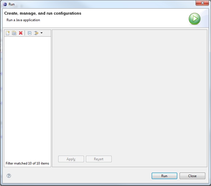

I'm new to eclipse so this is probably a relatively easy problem.
Every time I go to the run dialog, the filter does not show any items,
not sure if its supposed to be like this, I have no filters running, and even when I do its the same result.
I do already have items for the run, I just need to change things like the arguments in command-line programs.
All help appreciated;
index.php/fa/14267/0/

All of the configurations have been filtered - noticed the 'Filter matched 10 of 10 items' in the bottom of the tree viewer.
By default the launch dialog filters configurations that reference closed projects or missing / deleted projects. If you press the filters button in the tree viewer (the three arrows pointing right) and un-check all the options your configurations should show again.
If this means you have turned off the filters as I mentioned above, then that would likely be a bug, which you could file here: https://bugs.eclipse.org/bugs/enter_bug.cgi?product=Platform - choosing the Debug component.
