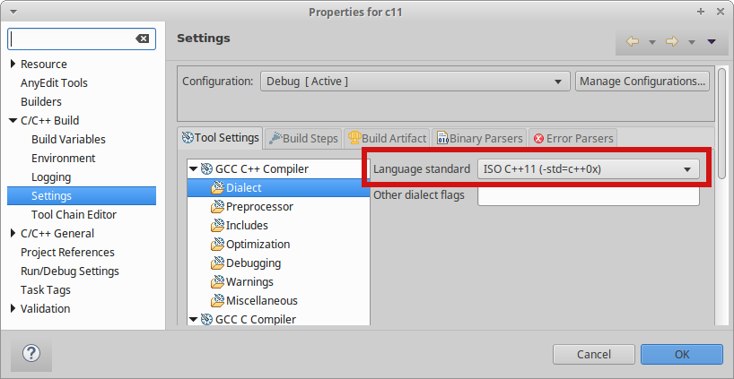

I tried reproducing the problem. When I changed the language standard:
index.php/fa/27857/0/

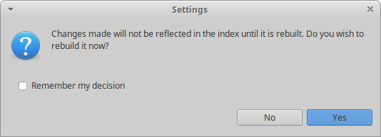

I was prompted to rebuild the index:
index.php/fa/27858/0/
After that the indexer behaved properly.
So there are a couple of things going on, perhaps sometime in the past "Remeber my decision" saved a No so you weren't prompted, or perhaps CDT didn't notice the setting change affected the index.
Either way, you should be able to resolve it by right-clicking on the project and choosing Index -> Rebuild.

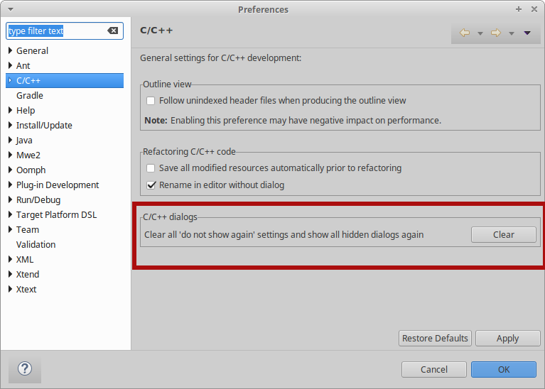

PS If you aren't getting the prompt when changing the setting, you can reset the Remember my decisions aka do not show again prompts in C/C++ Preference Page:
index.php/fa/27859/0/
