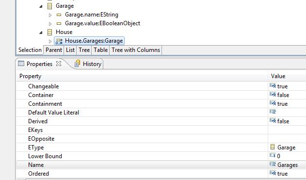

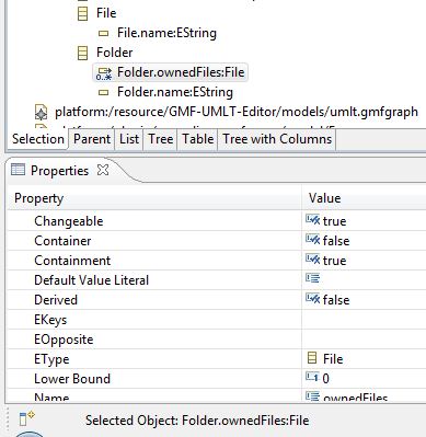

Here's the scenario that i'm working on, i've a House EClass, which has an EReference to Garage EClass.
-'House' EType attribute is set to 'Garage', and 'Garage' has to attributes for name & value. Please check the attached screen shot.

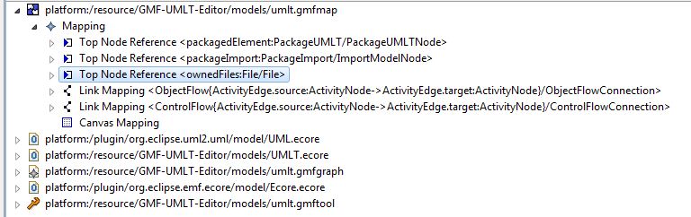

at the .gmfmap, i created a TopNodeReference having 'Containment Feature' 'House.Garages.Garage', and the Node mapping has the EClass 'Garage' as an Element. I attached a snap shot for the .gmfmap as well.
Does anyone have any idea how to get this error solved ?

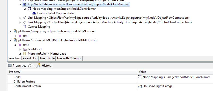

i've found a sample model that's doing something similar to what i'm trying to do, i tried to apply the same thing in my model but still i get the same error "Top level node 'Containment Feature' must be available in the diagram 'Domain Element' or its super-class" does anybody got any idea how to solve that?

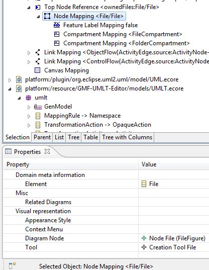

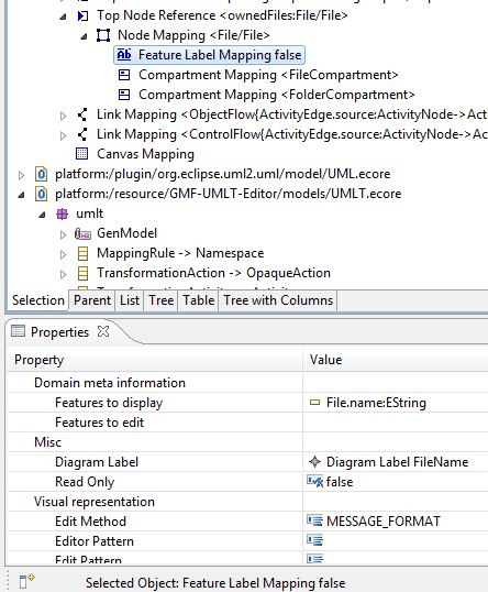

Re: TopNodeReference Creation [message #1037873 is a reply to message #1036500] Wed, 10 April 2013 01:37 Go to previous messageGo to next message
Hi Thomas,
Thanks for your reply!
Indeed the diagram node is a node of my graph model, it's not a child feature of any other figure.
As i mentioned in the last post i changed the EClass' names, i'm trying to make a bit for being more understandable.
The case now is i'm trying to create a TopNodeReference called Folder, but still u get the same error! i got no clue what this error means, i double checked all the properties and for me it seems fine.
I attached some snap shots for the .gmfmap and the .ecore maybe it'll make the picture a bit more clear.
Thx!
Mostafa.

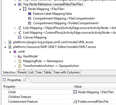

Re: TopNodeReference Creation [message #1039854 is a reply to message #1039099] Fri, 12 April 2013 13:50 Go to previous messageGo to next message
hey Thomas,
I think it should be fine now, please find the diagram attached, it's still not working tho! i'm still having the same error.

Re: TopNodeReference Creation [message #1043733 is a reply to message #1039854] Thu, 18 April 2013 00:02 Go to previous message
So i tried to update the diagram as seen in the attachment, but still having the same error!
Is there any way that i can overcome that error?
