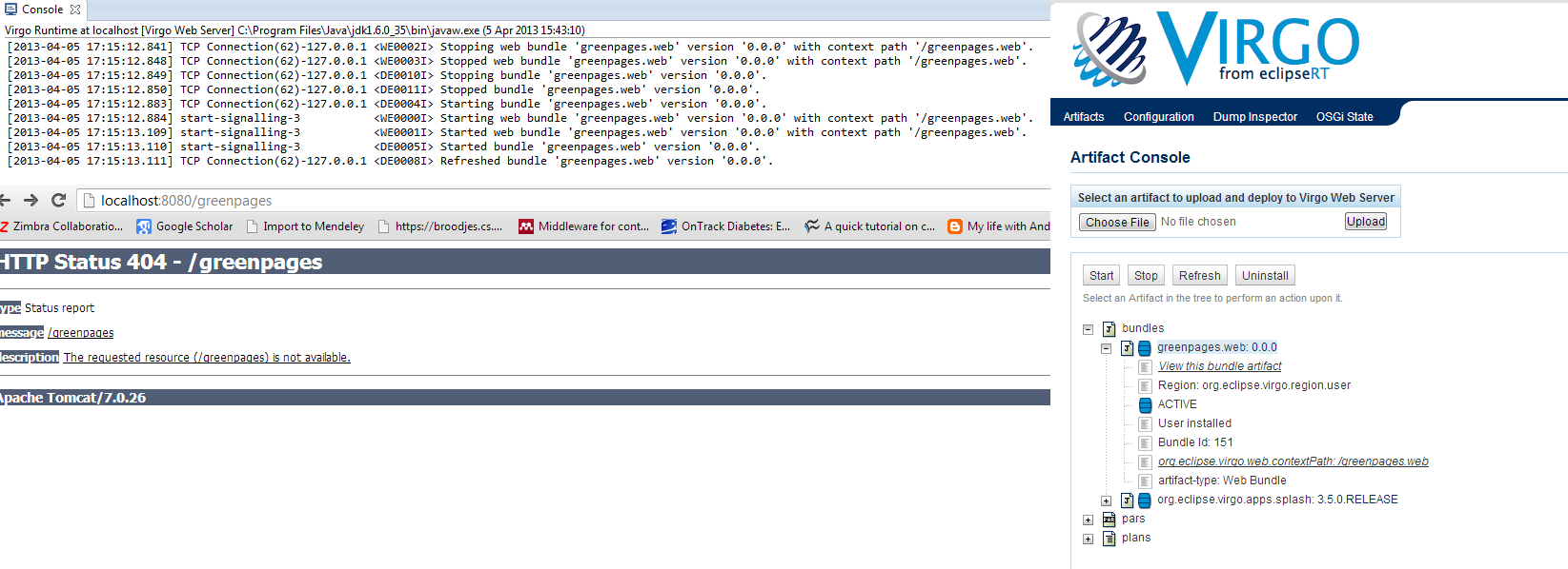

HI, I am also new to Virgo Tomcat server and trying to deploy a simple bundle as a web app but getting a lot of error. Is there any good way to learn how to deploy a web app a bundles and other services in the form of bundles too. I tried to deploy Greenpages sample with the guide provided but couldn't do so. My virgo server is not showing the hosted webpage even though a bundle is deployed but with version 0.0.0. How do we actually create template.mf?? Can someone please help me pointing in right direction?? I have to use Spring framework as I want to deploy this app in Cloud Foundry. PFA. the image.
Thanks.

Hi, It looks like it was deployed to /greenpages.web?
