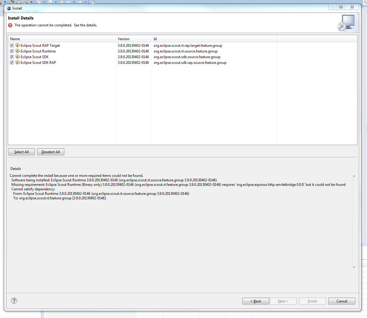

i'm trying to install Scout 3.9 with the nightly build (http://download.eclipse.org/scout/nightly) but the installation can not be completed because of missing requirements:
index.php/fa/14226/0/
I performed the following steps: (With Windows 7 professional, 64bit):
- Download Eclipse IDE for Java Developers (http://www.eclipse.org/downloads/packages/eclipse-ide-java-developers/junosr2)
- Help > Install new Software, update site: http://download.eclipse.org/scout/nightly
- Checked "Eclipse Scout RAP Target", "Eclipse Scout Runtime", "Eclipse Scout SDK" and "Eclipse Scout SDK RAP"
Thanks in Advance for any help,
David

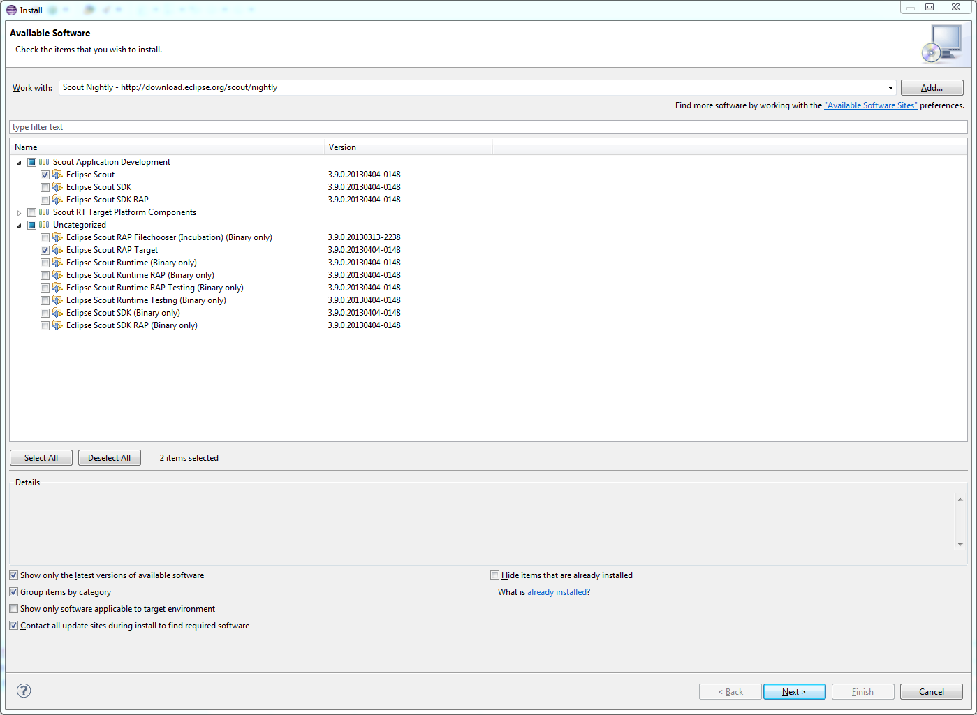

I usually use a classic Eclipse SDK version that you can find at [1] (Juno 3.8.2) or [2] (Juno 4.2.2) for example. However, the following installation guide should also work for Eclipse Java Developers EPP.
To install Scout Nightly into your Eclipse IDE, first add the Scout Nightyl Updatesite [3] by using "Help -> Install New Software...".
To get a "complete" Scout incl. runtime, SDK and RAP, you should choose the features according to the picture [4].
Please verify that you have checked the box "Contact all update site during install to find required software" so that depending bundles at the Juno updatesite are used.
The "Eclipse Scout" feature that was introduced with Scout 3.9 is a so-called super-feature and contains the following sub-features:
  • Eclipse Scout Runtime
  • Eclipse Scout Runtime Testing
  • Eclipse Scout SDK
  • Eclipse Scout SDK RAP
The feature "Eclipse Scout RAP Target" contains the RAP bundles so that you can extract them to your local file system when creating a Scout project with the RAP UI.
Please tell me if the update does work now.

Re: Scout 3.9 nightly build [message #1033605 is a reply to message #1033591] Thu, 04 April 2013 08:29 Go to previous messageGo to next message
Hi Ken,
it turned out i disabled the option "Contact all update site during install to find required software", after enabling it again everything works fine.
Many thanks for your help,
David

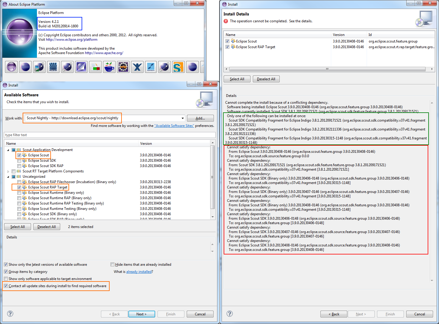

I've tried updating one of my eclipse installations (Juno 4.2.1; Scout 3.8.1) to the nightly build according to the instructions from Ken.
I get the following errors:
index.php/fa/14276/0/
From those marked in green, I assume that I first need to uninstall Scout 3.8.1, is this correct?
Will this automatically resolve the unresolvable dependencies marked in red, as well, or do I need to do anything else to fix this?
Cheers

Re: Scout 3.9 nightly build [message #1036338 is a reply to message #1036311] Mon, 08 April 2013 04:48 Go to previous messageGo to next message
Urs Beeli wrote on Mon, 08 April 2013 04:11
Hi Urs,
Yes, your assumption is absolutely correct. Please have a look at [1], in your case especially at bug [2].
In summary, feature ids were renamed in Scout 3.9, that's why an update from Scout 3.8 to Scout 3.9 does not work anymore.
That was the reason why I used an Eclipse Classic SDK version (i.e. without a previous version of Scout installed) for my above guide.
The red part should not appear if you use an Eclipse version where Scout is not installed.
Cheers,
Ken
[1] http://wiki.eclipse.org/Scout/Migration/3.9
[2] https://bugs.eclipse.org/bugs/show_bug.cgi?id=396871
