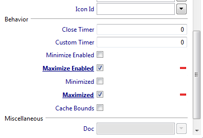

Hi all,
I have the following problem when I show a form in SWT: the form is not maximized as it's launching the application via Swing.
The form is so configured:
index.php/fa/14217/0/
and is invoked as follows:
      //Open the detail order form
      OrderDetailsForm form = new OrderDetailsForm();
      form.setIdCommission(idCommission);
      form.setCommission(commission);
      form.setMaximized(true);
      form.setMinimizeEnabled(false);
      form.setMaximizeEnabled(true);
      form.startNew();
      form.waitFor();
I can not understand why is maximized in Swing and in SWT no.
Can anyone help me to understand where is the problem?
Thanks in advance for your help

Marco, thank you for the hint - and yes it is a bug. I opened Bug 405048 to track this issue.
/andreas
