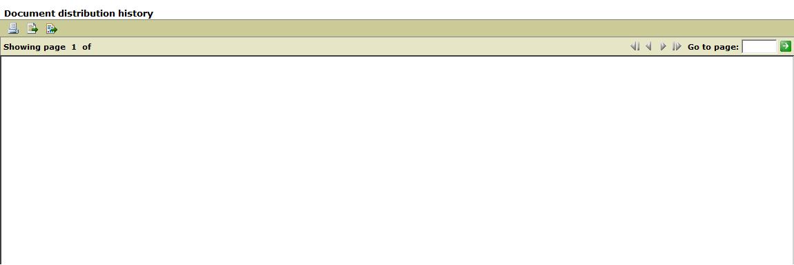

Hi Michael,
Thanks a lot for your response. I have attached a screenshot of the output that I'm getting. It is completely blank. Even the input parameters in the report that is passed during runtime which is supposed to be there according to my design is also missing in the report.The report runs for a minute displaying loading.. and then that message is suddenly not there and I immediately close the window. Should I keep the window open for sometime?

Re: Birt report runs for few minutes displaying "loading ..." and then goes blank [message #1030058 is a reply to message #1029663] Sat, 30 March 2013 12:14 Go to previous messageGo to next message
Try just running it and leaving it open for a bit, just in case. You don't see any errors in the log file? It just stops? If so, that's another reason I'd give it just a bit after the loading... goes away. Let me know.

Hi Michael,
I tried your suggestion and left the report open after the message loading.. goes away for 3-4 minutes but I'm still facing the same issue. The report is still blank.
