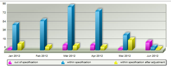

I have a bar chart that shows for each month data that is split into three categories:
  • within specification
  • within specification after adj.
  • out of specification
It can happen that one of these categories is not present for several months.
Therefore it could happen that for a status the bar color could change.
But I want to have a fixed color theme e.g.
  • within specification = blue
  • within specification after adj. = yellow
  • out of specification = red
Is this somehow possible?
Next is the order of the bars. I am only able to sort them after the name. I would like to also sort them like the first list...
Anyone an idea?

Re: Fix color for series in bar chart [message #1027391 is a reply to message #1027046] Tue, 26 March 2013 19:16 Go to previous messageGo to next message
You can set the color using a script similar to:
function beforeDrawDataPoint(dph, fill, icsc)
val = dph.getBaseDisplayValue();
if (val == "within specification"){
fill.set(255, 0, 0);
You should be able to change the order by putting in a custom expression on the sort expression for the optional grouping category.

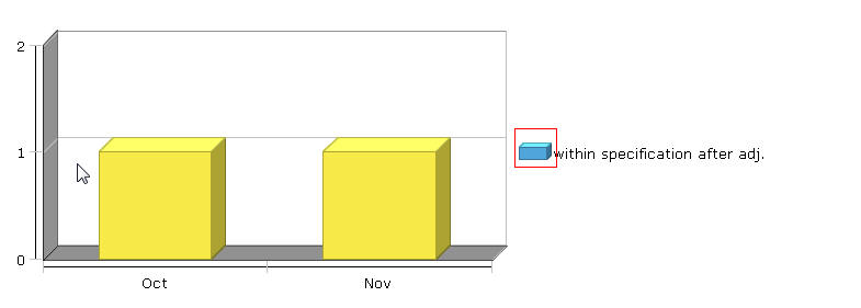

Re: Fix color for series in bar chart [message #1033572 is a reply to message #1027046] Thu, 04 April 2013 07:38 Go to previous messageGo to next message
Ok,
just tried it with a normal chart.
I had to change things a little, because I want to change the color depending on the series:
That works for me:
function beforeDrawDataPoint( dph, fill, icsc )
	test = dph.getBaseValue();
	test2 = dph.getSeriesDisplayValue();
	if (test2 == 'within specification'){
		fill.set(255,255,0);
	else {
		fill.set(255,0,0);
ps: I have one more issue. The legend of the series still shows the old color. Is there a possible way to change that one also?

Re: Fix color for series in bar chart [message #1033661 is a reply to message #1033572] Thu, 04 April 2013 09:43 Go to previous message
just solved it:
function beforeDrawLegendItem( lerh, bounds, icsc )
	var label = lerh.getLabel().getCaption().getValue();
	if( label == "within specification")
		lerh.getFill().set(0,158,227);
	else if (label == 'within specification after adj.')
		lerh.getFill().set(247,234,72);
	else if (label == 'out of specification')
		lerh.getFill().set(227,41,9);
	else if (label == 'unknown')
		lerh.getFill().set(255,0,128);
