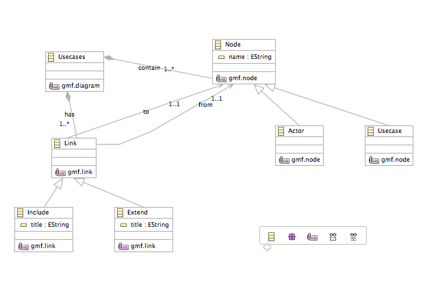

Below is my .evl. I have also attached the Ecore diagram, perhaps it might help

  • Attachment: Usecase.png

Usecase doesn't seem to be a sub-class of Actor in your metamodel so the following line should be commented out (see the EVL chapter of the Epsilon book for the semantics of satisfies(...))

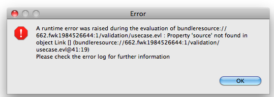

Thanks, this is helpful, but another problem occured. I made the changes you suggested including changing the markerTypes for the two MarkerResolutionGenerator to "usecase.example.diagram.diagnostic" (or shpould I have changed only one?).
This worked for the uppercase constraint (though it didnt give me an option for a quick fix), but instead of valiating the MustLinksame Constraint it raised an exception please see attached.
regards

The error message is saying that you're referring to the "source" feature in Link, which does not exist according to your metamodel. Links seem to have the "from" and "to" features, not the "source" and "target" features you're using in the EVL file.
Antonio
