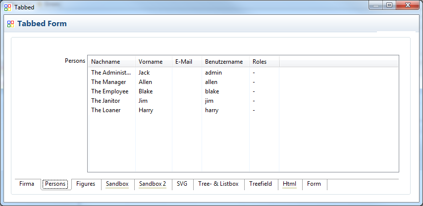

Is it possible to have the tabs of a TabBox shown at the bottom instead of at the top?
To illustrate the effect I'm looking for, see this screen shot:
index.php/fa/13960/0/

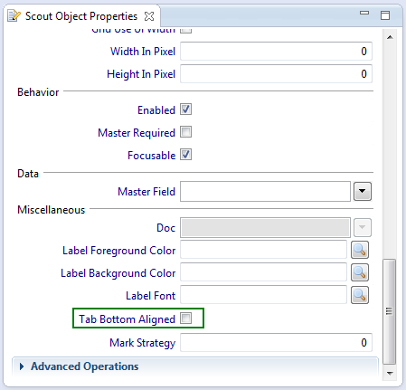

This gives us SDK support for the new property when using a "BottomAlignedTabBox" instead of a "TabBox":
index.php/fa/14242/0/

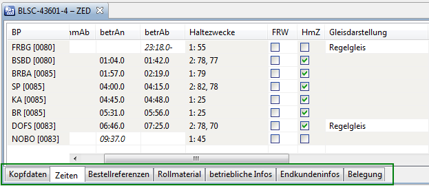

And in our client, this looks as follows:
index.php/fa/14244/0/
