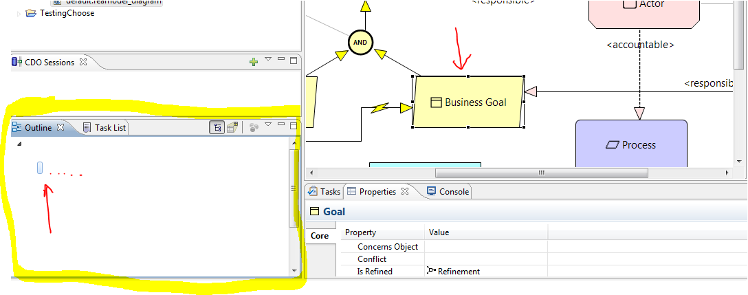

When i am modeling a diagram, my outline view stays blank. The object are there though, because if i select a node in my diagram, something is selected in the outline view. (see attachment, it will become clear).
so: How can i display the names of my objects in the outline view?

I would very much like to try this out, though since i'm an eclipse amateur, i don't know how to use this EcoreTools outline in a runtime editor. I already use it when making an ecore diagram model and find it very useful.
I can see in the Plug-in Development screen that the org.eclipse.ecoretools.diagram.ui.outline is installed, but how do use this ecore tools outline when i'm modeling in my generated diagram?
