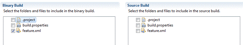

i checked and i couldnt find any Application.xmi entry, but I also cannot find a way to add such an entry. I also tried to add the line:
bin.includes = Application.xmi
to build.properties, but that gave me an error when I tried to export. Can u say me how I can include the Application.xmi?
Greets, Daniel

Re: running exported rcp app [message #1020957 is a reply to message #1020947] Tue, 19 March 2013 04:53 Go to previous messageGo to next message
Hi Daniel,
your project seems to be feature based. I don't know how/if an export of a feature project works. Maybe someone else does know that. You could configure it to be plugin-based. Then the build.properties should look different.

Re: running exported rcp app [message #1021028 is a reply to message #1021022] Tue, 19 March 2013 07:51 Go to previous message
That was it. I was working on the build.properties in the feature package...
Found the one in the main package, added plugin.xml and application.e4xmi to the build and now it works.
Thank you all for your help!
