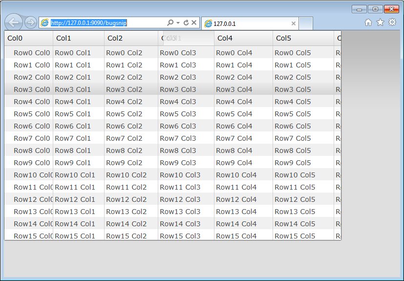

Before I open a bug, could someone confirm if this is indeed a bug, or working as designed in RAP... basically I have a Tree which has setMoveable(true) for all columns, but if I try to actually drag the columns around to change their order, the 'ghost' of the column header gets left on the display and no re-ordering is done.
Same code works ok in SWT.
Just to note, I'm using quite a recent Nightly of RAP from a few days ago.

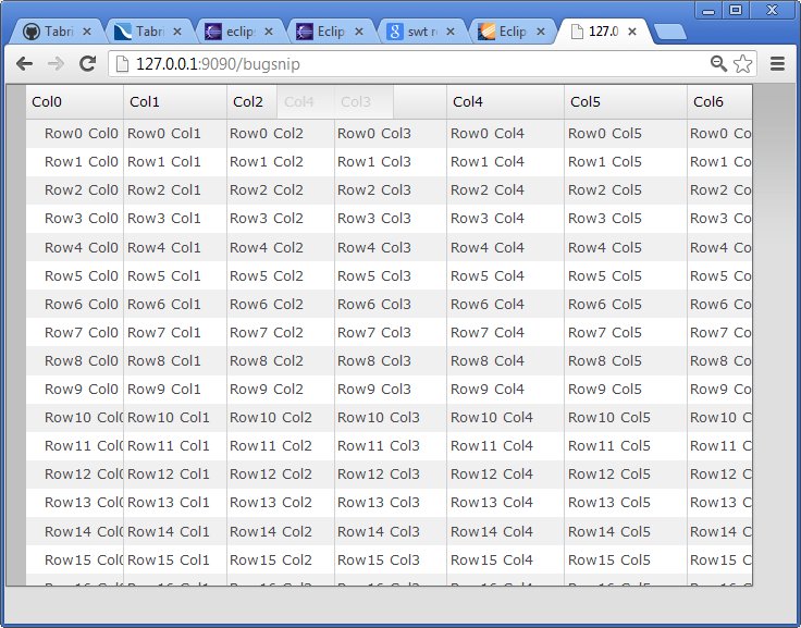

I have tried Chrome 25 and IE9 and FF7.0.1 on that same Win7 machine, as well as connecting Chrome on a Nexus7 Android - they all behave the same way. I can drag a column heading left/right, but when I let go of it, it just leaves the ghost at that position.
Screen shot of IE9 and Chrome from Win7:
IE9:
index.php/fa/13864/0/
Chrome25:
index.php/fa/13865/0/
Best regards, John

Just a wild guess before i dive deeper into that issue:
Do you run your application in SWT Mode[1]? That would explain this
behavior completely, since you have no main loop in your snippet.
How do you launch the snippet? Does inserting the main loop again fix it?

STUPID ME! Shocked
Sorry Tim, you are absolutely correct... I add and remove that main loop constantly in my BugSnippet code as I'm constantly trying things out in SWT, RAP and Tabris! Just forgot to do it on this occasion!
Totally my fault... adding the loop back in sorts it out!
