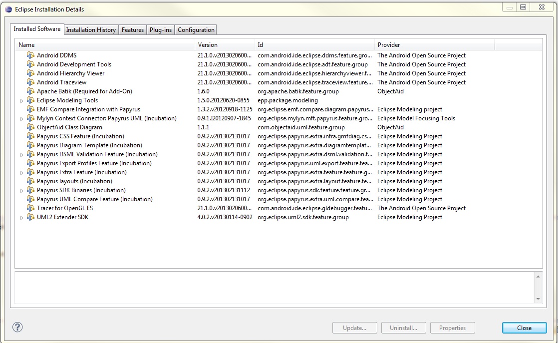

Re: Problem creating new Papyrus project within Eclipse [message #1018667 is a reply to message #1018659] Thu, 14 March 2013 05:26 Go to previous messageGo to next message
Hi Camille,
Thanks for the response.
I am using eclipse-modeling-juno-win32-x86_64
with all updates applied
and I am using Papyrus-Update-incubation-0.9.2
I do not seam to have UML, Profiles, and SysML.
Can you suggest something I could try.
Stuart

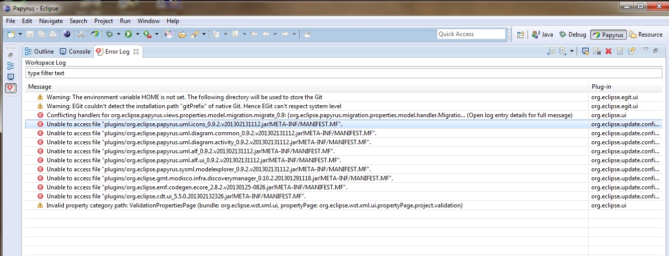

Re: Problem creating new Papyrus project within Eclipse [message #1018719 is a reply to message #1018711] Thu, 14 March 2013 06:59 Go to previous messageGo to next message
Hi Camille,
I went into my log and deleted it.
Then closed and opened eclipse.
I then looked in the log.
I then tried to create a papyrus model
I recorded the process. video.avi
no new error were created.
' this is what was in the log file when I opened it.'
see attached log-file.txt
this line looks suspect.
!ENTRY org.eclipse.ui 4 4 2013-03-14 20:48:06.338
!MESSAGE Conflicting handlers for org.eclipse.papyrus.views.properties.model.migration.migrate_0.9: {org.eclipse.papyrus.migration.properties.model.handler.MigrationHandler} vs {org.eclipse.papyrus.migration.properties.model.handler.MigrationHandler}
Any ideas on how to fix that and the other errors?
thanks again for your help
Stuart

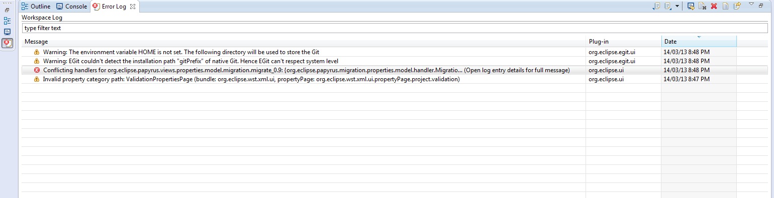

Re: Problem creating new Papyrus project within Eclipse [message #1018746 is a reply to message #1018719] Thu, 14 March 2013 08:00 Go to previous messageGo to next message
Hi Camille,
upon restart there appears to be a few more errors.
see attached.
is there a way to uninstall Papyrus-Update-incubation-0.9.2
and try reinstalling it.
or is there a way to solve the errors?
Re: Problem creating new Papyrus project within Eclipse [message #1018760 is a reply to message #1018746] Thu, 14 March 2013 08:26 Go to previous messageGo to next message
There's indeed a problem with your installation, although I couldn't tell what's wrong.
To uninstall Papyrus: Help > About Eclipse > Installation details. In the Installed Software tab, select all "Papyrus" features, then "Uninstall".
I just tried a clean installation of Papyrus 0.9.2 with all extra components, and it works fine (Only the sources cannot be installed, but they are never required).
Re: Problem creating new Papyrus project within Eclipse [message #1019215 is a reply to message #1018760] Fri, 15 March 2013 04:55 Go to previous message
Hi Camille,
Thanks for your help.
I uninstalled Papyrus 0.9.2 and re-installed it and now it working.
Thanks again.
Stuart
