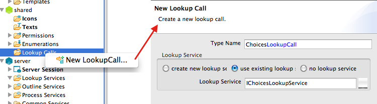

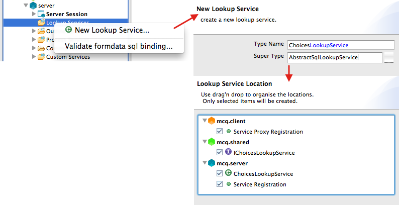

I like to add a point to your scenario 1:
It is possible to create the lookup service first as you have described:
index.php/fa/13829/0/
When you create the lookup call (from shared part) you just indicate that you want to re-use and existing lookup service (second radio button)
index.php/fa/13830/0/
I hope it helps.
