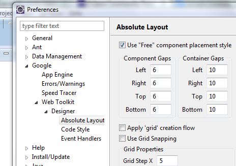

Indications that I have installed WindowBuilder:
1) Window->Preferences->WindowBuilder...Code parsing, swing, SWT, UI Toolkits.
2) Window->Preferences->Web Toolkit->Designer...Absolute Layout, Code style, Event Handling.
3) File->New->WindowBuilder->GWT User Interface. (also contains project pallet, swing designer, SWT designer).

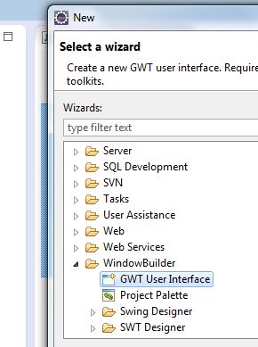

So I do File->New->WindowBuilder->GWT User Interface. I get the following dialog:
"Install GWT Toolkit"
"Create a new GWT interface. Requires loading additional WindowBuilder toolkits"
"Installing Toolkit..."
Brings up an additional dialog with 8 items: Google Plugin for Eclipse 3.7 (!), GWT designer (3 items), WindowBuilder (4 items)
Next or Finish buttons on the dialog have no effect. I can only cancel the dialog. If I unselect the Google Plugin for Eclipse 3.7 I can click install but the install fails.
So, something isn't working. I see there is currently a lot of activity moving WindowBuilder to Eclipse. The forums I have searched give mixed reviews on whether WindowBuilder works with Juno 4.2, or even works at all.
I have attached a screen print of the dialogs I am seeing.

I believe you Eric, but I have been unable to get it installed properly. I did a fresh install of everything, as described below but still ended up with no GWT option in the Preferences->WindowBuilder dialog.
Below is the procedure I followed. I am certain that I am not the only one having this problem so if you could point me to a resource that goes through the installation step by step I'd really appreciate it. I have also attached screen clips from how it should look (from the Eclipse Indigo WindowBuilder Pro documentation) and what I have.
--Code Parsing
--Swing
--SWT
--UI Toolkits
4) Installed GWT SDK: dl.google.com/eclipse/plugin/4.2
-- Google Web Toolkit SDK 2.5.0
Result:
Same as above
