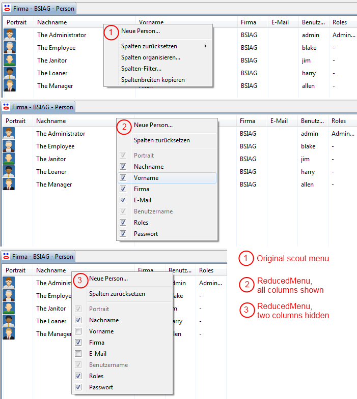

And this is what 11 lines of code changes can look like using the above four classes:
index.php/fa/13921/0/
