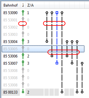

I am displaying some graphical information in a table. I want to show some processes that progress vertically. Ideally, I would like to have a seamless vertical line for each process.
Unfortunately, it seems that when each table row is rendered, a gap of 3 pixels is left between the rows (see screenshot, gaps marked in red).

I have tried setting the ConfiguredRowHeightHint property to a certain size (that matches the height of the icon being used), but it seems that - as the name suggests - this is a hint only and not enforced.
Is there an easy way to suppress this "spacing" between rows?
If there is no easy way, where would I start doing this the hard way? Very Happy
I guess I would need to look at the SWT implementation of the table classes?

The spaces are due to the SWT/JFace table. Therefore it is hardly possible to suppress this spacings.

Thanks for your feedback. We have in the meantime decided to split the display of this data into a separate SVG field, so this is no longer a big concern.
