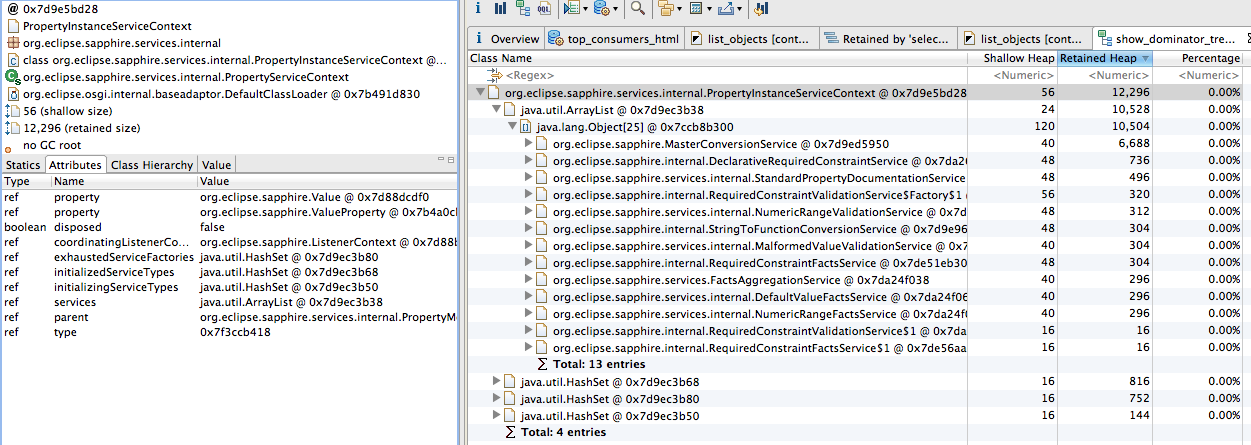

I finally got some time to look back into this. Analyzing a smaller file, I was pointed towards the ServiceContexts. I then loaded up a larger (1.5MB XML file and examined the heap). It appears that duplicating the HashSets containing the service lists for each Element or Property in the model is contributing to the memory issue. An example is below:
The source node from the XML file contains the tag of <dim> and the value of "1". The PropertyInstanceServiceContext for this node retains ~12KB of data. Using the Memory Analyzer to look at the dominator tree, the service ArrayList contributes to 10KB of this with 6KB+ being retained by the MasterConversionService object, almost all retained by the conversions HashSet.
I also noticed, that although not exactly the same, most of the MasterConversionService objects contain references to 99% of the same ~65 conversions. Although I haven't investigated, I would think that one of these conversions being different for a particular node would be the exception rather than the rule.
Would it make sense to pool the MasterConversionService objects and reuse a particular object with the same set of conversions? XML files with the same hierarchy/tags modeled as a Sapphire Property should have the same set of conversions/overrides and shouldn't differ in how they need to be converted...
The latest git repo did help the utilization quite a bit (vs the 0.6x series I started with, eclipse's heap memory usage is now in the 700MBish range for the same file).

Re: Ideas to reduce memory usage [message #1063876 is a reply to message #1061558] Fri, 14 June 2013 12:18 Go to previous messageGo to next message
Thanks for the analysis. I have opened a bug to track this issue. I definitely think we can do something to improve the memory footprint of this service. Could you add yourself to this bug?
https://bugs.eclipse.org/bugs/show_bug.cgi?id=410836
Re: Ideas to reduce memory usage [message #1064561 is a reply to message #1063876] Wed, 19 June 2013 18:08 Go to previous messageGo to next message
I implemented some changes to MasterConversionService and ServiceContext to reduce memory lookup. See the referenced bug for Git commit link. Please grab the latest and re-evaluate. Your focus on tuning resource consumption with large model instances is very valuable to the project.
