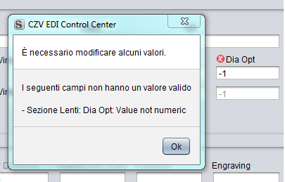

I have the following question: I have my form in Scout with many fields in which I have defined a set of validation rules (Exec Validate Value), and so far no problem.
Now on the OK button I customized the "Exec Click Action" to perform certain operations, that I want to be done only when all fields are correct according to various validation rules set.
When I click on OK button and at leat one field isn't valid, a popup is displayed automatically with a message (see image):
index.php/fa/13736/0/
but the instructions in the method "Exec Click Action" are still performed.
How do I figure out when it open this popup? What condition I should test?
Thanks in advance for help and suggestions

Re: Button "OK" [message #1016729 is a reply to message #1016714] Thu, 07 March 2013 08:55 Go to previous messageGo to next message
I think that it is not common to have business logic in the ExecClickAction of the OK button. When the OK Button is clicked, it is clicked independently of the form state (invalid fields). The role of the OK Button is to trigger a doSave() on the form nothing more. (It is possible to call doSave() from another button or as reaction of a specific event)
After that the FormHanler will handle the form life-cycle. You can add additional checks to the build in checks (like the message box you mentioned):
* ExecCheckField
* ExecValidate
* ExecStore
ExecStore is only called if CheckField (build in and custom) and ExecValidate (build in and custom) are successful. I recommend you to move you logic there.
If you have two form hanlders (one for NEW and one for MODIFY) and your business logic is the same you can put it in a function that you call in both cases.
