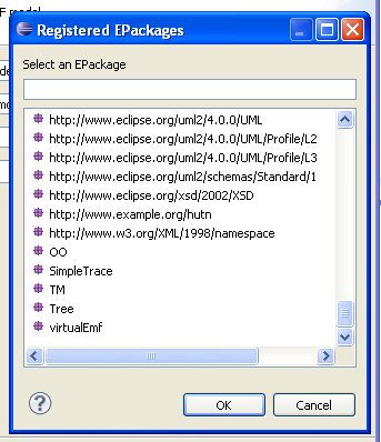

1. Despite the fact I get a confirmation that each metamodel is registered successfully in console, in the Epackage registry (after refresh), only one of these metamodels 'sticks' in the list of registered packages

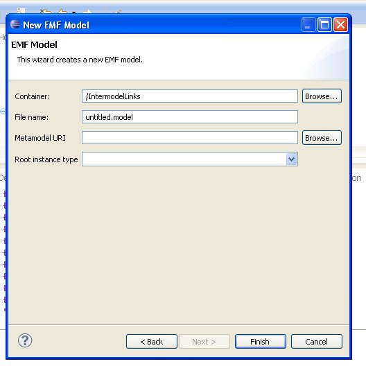

2. When I try to create a model versus the metamodel that appears to be registered, I see no drop down of registered models in the dialogue. If I browse to select the metamodel I don't see the metamodel listed.

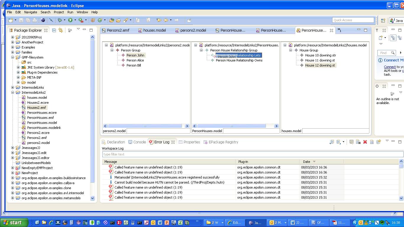

My new stumbling block with the same Modellink example is at the point where I attempt to populate the linking model. So I've created a linking metamodel, registered it, and used the modellink wizard to attempt to create linking instances. Although I can create an instance in the linking model (create child), if I drag either a Person or a House instance on to the centre pane, the editor does not accept it (get the 'no entry' symbol). Any idea of the problem?
Screen dump, and relevant emf files attached. I attempted to include PersonHouses.modelink and PersonHouses.model, but get the "You can only use links to eclipse.org sites while you have fewer than 5 messages." error message. Can send if required.
