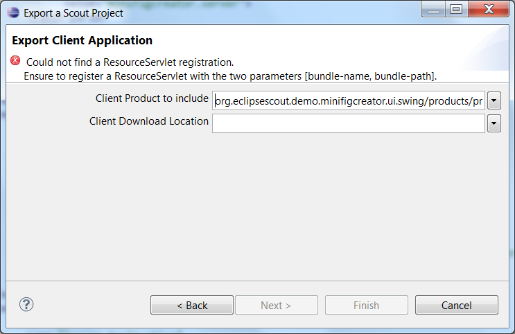

I am trying to export my scout application with the export wizard.
I am blocked here:
index.php/fa/13702/0/
What does mean:
Could not find a ResourceServlet registration
In my plugin.xml in the server. I have:

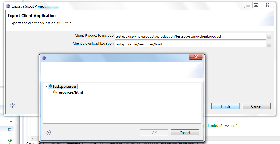

Same Eclipse SDK Version:
I have tried with a new application.
Here there is no problem, it is possible to select a "Client Download Location".
index.php/fa/13706/0/
I have compared the file, I do not see any difference.

Never mind, it has nothing to do with sharing project with EGit or not.
The value in bundle-name was invalid.
      <servlet
            alias="/"
            class="org.eclipse.scout.rt.server.ResourceServlet">
         <init-param
               name="bundle-name"
               value="[color=green]org.eclipsescout.demo[/color].minifigcreator.server">
         </init-param>
         <init-param
               name="bundle-path"
               value="/resources/html">
         </init-param>
      </servlet>
When I renamed my bundle this was not renamed and was wrong.

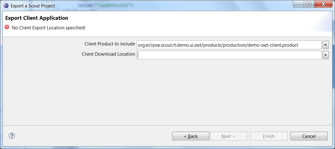

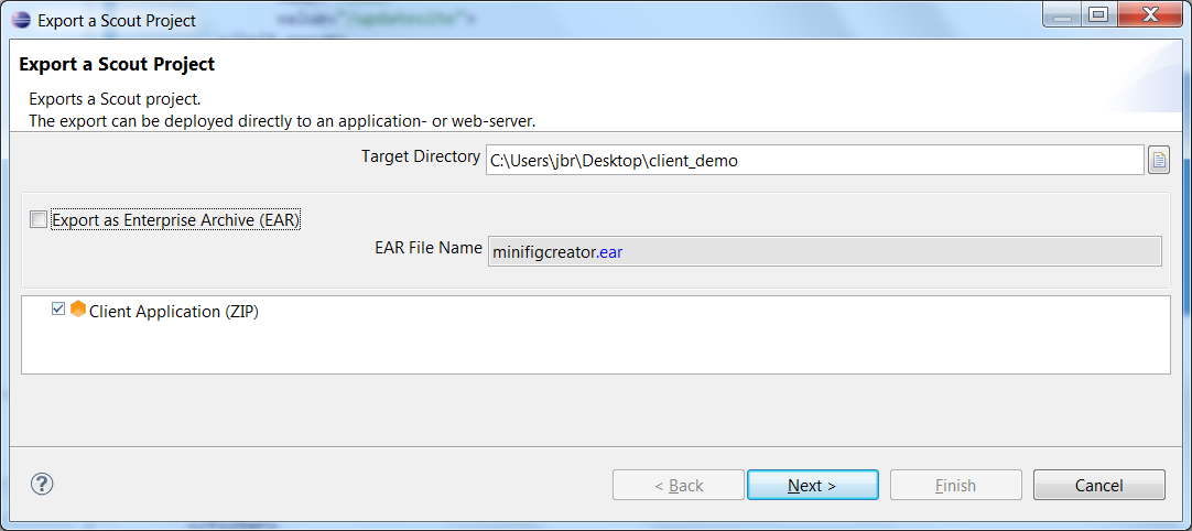

Step 1 looks good:
index.php/fa/13728/0/
Step 2 show an error:
index.php/fa/13729/0/

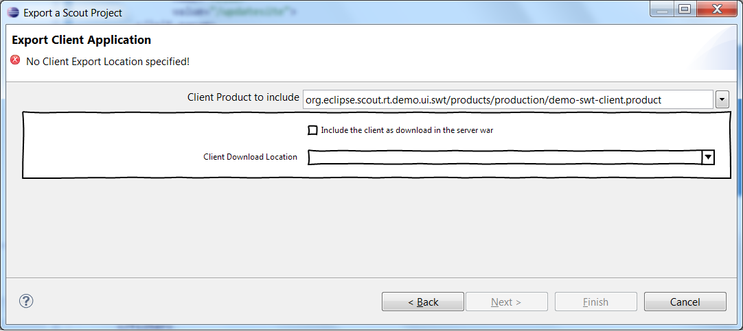

I think this could be improved, by providing a checkbox "Include the client as download in the server war" on the "Export Client Application" step. If checked a "Client download location" is requested. If not checked this field is inactive. In case of a client only application (or server not selected in the first step) this check box needs to be disabled and unchecked.
index.php/fa/13730/0/
