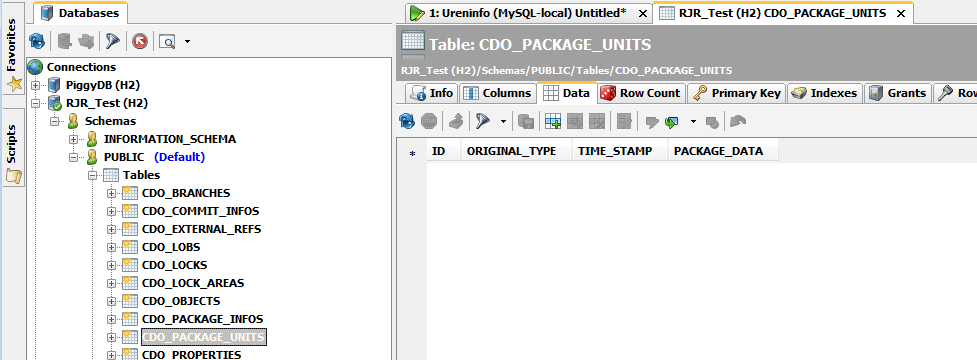

I am trying to reproduce the CDO/Embedded example as it would cover one of our use-cases: http://wiki.eclipse.org/CDO/Embedded
Things seem to start working well, but after creating a few tables in the H2 database the program stops with an UnsupportedOperationException on the sql statement:
INSERT INTO cdo_package_units VALUES (?, ?, ?, ?)
I included the console-output as an attachment, and also the java-source as I am using it, and a picture from dbVisualizer which shows a view of the tables that where already created before this exception ocurred. BTW: all the created tables are empty.
Can anybody point me where I am going wrong (I still consider myself a newby Wink)?
Thanks in advance.

I *think* this problem can be caused if the org.eclipse.emf.ecore.xmi bundle is not properly deployed to the server. Can
you please check that?
I'm currently working on the problem that some databases don't support rollback of a series of DDL statements in case
one of them fails. Not sure if that's related.

Thank you for your pointer!
Everything works fine now that all the tables were created.
Rui
