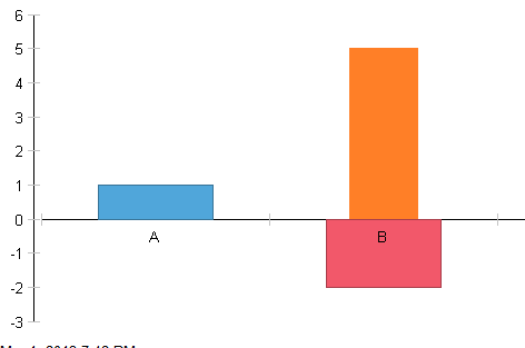

Re: Variable bar width in bar graph [message #1015739 is a reply to message #1015668] Fri, 01 March 2013 20:44 Go to previous messageGo to next message
With an image for the third bar, you can make it look like this:

Hello Michael,
I did try the image solution for modifying the bar width, but it didn't work for me because in my report the number of x-axis groups is determined at run time. Because images are repeated rather than stretched when they don't match up to a bar size, creating the illusion of a thinner bar depends on knowing the width of the actual bar beforehand. I'm not sure if there is a way around this.

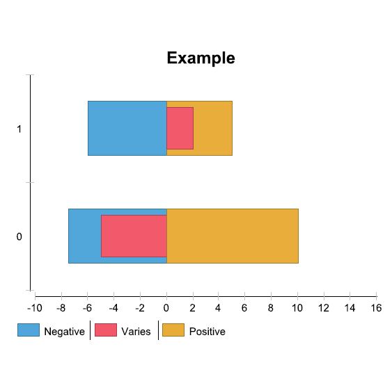

Sorry, I said columns when I meant series. There will always be three series. One of the series will always have a negative bar, one will always have a positive bar, and one can be either positive or negative. There may be more than one entry in the chart however, so the total number of columns does vary.
I have attached an example of my situation. Currently, I am using stacked bars. What I want is to make the red bar thinner, so that whichever bar ends up behind it can be seen. The number of rows in the data set will vary.

I don't think that changing the series spacing alone can resolve this issue. I have attached an ms-painted demo of what I am trying to create. I need to both change the width of a bar, and cause one bar to occlude one another.

Take a look at this modification of your report. The formula to figure the offset might need to be tweaked a little, if you add a title, specifically the -10 portion. This accounts for the dead space at the top of the chart which would be increased with a title. This was just a first shot at a formula to figure the offset needed, but it should be a start. I'll let you know if I find a better way.
I unstacked the second series and then moved it down half the offset and the stacked bars up half the offset, to meet in the middle. I added a parameter to the report to determine the number of rows in the dataSet, so that different variations could be tested. This appears to work pretty well for any value.
Let me know if you have questions.
