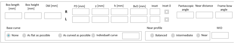

This time my problem is organizing the layout of a form, in my form I have many fields (text, checkbox, smart field) divided by different group box. Some of these group box are within other.
My problem is that I cannot sizing correctly the fields and especially they overlap (see image as example)

this is an example of layout that I want obtain:
index.php/fa/13628/0/

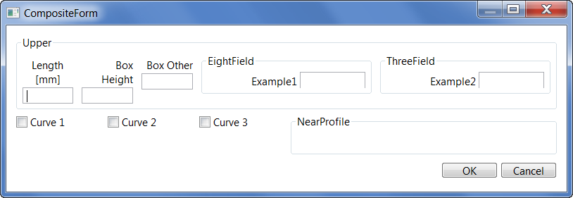

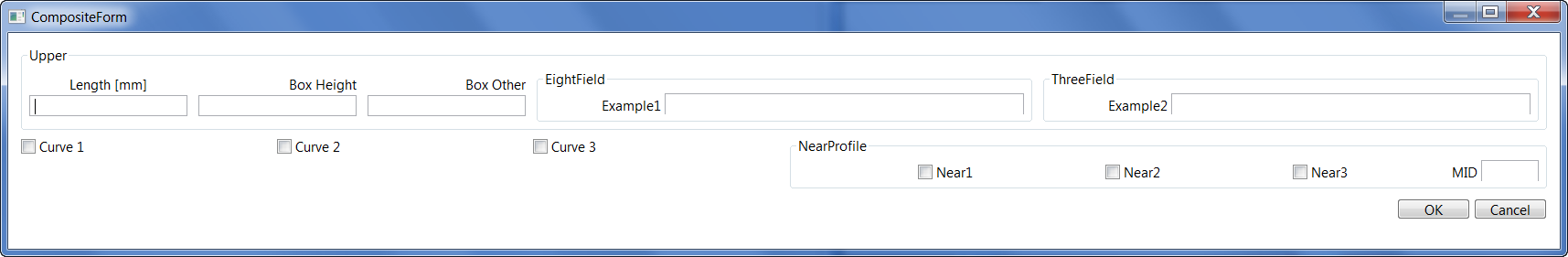

It is not so difficult, to produce the layout you want as you can see in the next image.
index.php/fa/13661/0/
It just needs some experiments for various situations.
index.php/fa/13662/0/
I have attached part of the code that produced it. And as you can see , i have created three example templateFields.

There are no mistakes, Just unfinished configuration of fields. You have to take care for the configuration of each field indivindually. I used some configuration options of Scout such as getConfiguredLabelPosition(), getConfiguredWidthInPixel(), getConfiguredGridColumnCount() for demo purposes. I also created three example templates.
The rest its up to you.

One thing you might want to look into is something that I failed to realise when I first started working on more complex scout windows: The layout manager used will always try to "stretch" your fields to make use of the available window/form size. This is controlled by the "Fill Horizontal" and "Fill Vertical" checkboxes in the advanced properties. If you want pixel-precise field sizes, it won't be enough to set "Width/Height In Pixel", you will also need to deselect the two "Fill" checkboxes.
Another thing that helps me to manage layouts is to liberally use group boxes (you can hide their borders, so they're invisible) to avoid unwanted wrapping of fields to the next row or column.
