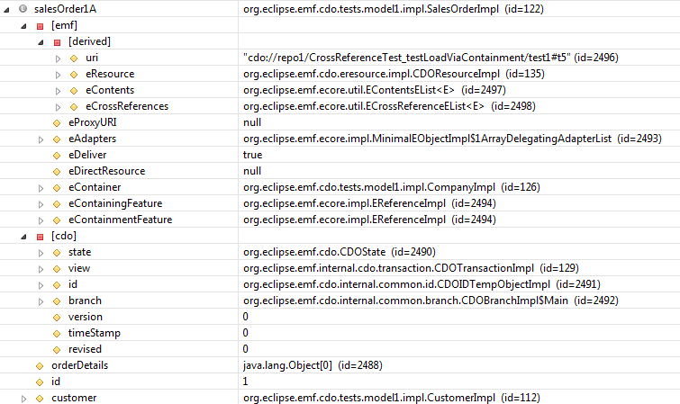

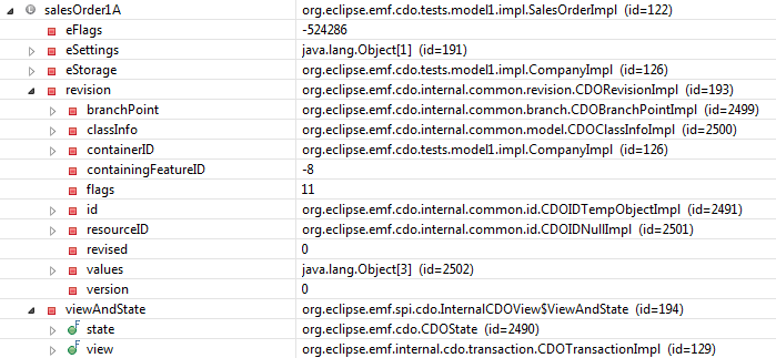

Indeed I worked on such a thing but didn't open source it. I'm
considering selling it for a small fee to cover development costs.<br>
<br>
With the two separate plugins for EMF and CDO logical structures the
following:<br>
<br>
<img src="http://www.eclipse.org/forums/index.php?t=getfile&amp;id=13620" alt=""><br>
<br>
turns into this:<br>
<br>
