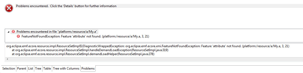

When I close it and and try to open it again with the same editor I created it in I get an error (attached as image also, as is the stack trace):
Problem encountered in file "platform/resource/a/My.a"
FeatureNotFoundExeption: Feature 'attribute' not found (platform/resource/a/My.a,3,21)
If I open the model and change the name of the references backto 'attr' (as defined if the ExtendedMetaData wasn't set) it works, ie. it can be loaded.
