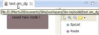

Re: GMF Saving issue [message #1016021 is a reply to message #1015923] Mon, 04 March 2013 10:54 Go to previous messageGo to next message
Here are the screenshots
This case is on the creation of the diagram file, and every node i create here are succesfully save on the model files. Let's say it is Editor N°1
index.php/fa/13668/0/
This case is when I open my diagram with a double clic on the file.
No nodes created here will be saved on the model. This one is editor N°2.
index.php/fa/13669/0/
Event if i restart Eclipse, it's the same, Editor 1 is able to save correctly, and N°2 can't.
It mean that, if i want to work with my diagram, I must let Editor 1 open, if i close it, it's over Sad
  • Attachment: it works.JPG
    (Size: 9.97KB, Downloaded 655 times)
  • Attachment: wont work.JPG
    (Size: 6.84KB, Downloaded 671 times)
Re: GMF Saving issue [message #1016047 is a reply to message #1016021] Mon, 04 March 2013 12:39 Go to previous messageGo to next message
Hi Valerian,
this looks strange to me. Especially, I never encountered an editor tab displaying an absolute path of a model file.
Do you have your projects somewhere hostet, where I could take look at?
From your problem description I can't really figure out, what could be the problem.
Thomas
