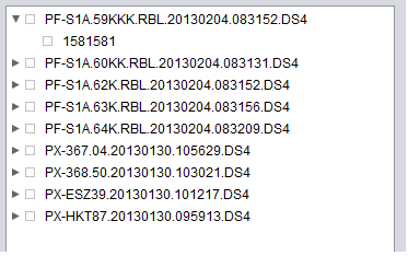

Re: Tree Box [message #1015331 is a reply to message #1015204] Thu, 28 February 2013 04:25 Go to previous messageGo to next message
Hi Jeremie,
thank you for your help, now I load the tree-box with a similar query that you have posted:
index.php/fa/13595/0/
Now my question is: what means all the various null in the query you posted?
Now I would need to set the check box of the node based on a boolean field produced by the query that populates the tree-box, is this possible? How?
  • Attachment: TreeBox.png
    (Size: 7.95KB, Downloaded 1095 times)
Re: Tree Box [message #1015374 is a reply to message #1015331] Thu, 28 February 2013 07:04 Go to previous messageGo to next message
From the wiki page:
http://wiki.eclipse.org/Scout/Concepts/Sql_Lookup_Service#Properties :
(..) The AbstractSqlLookupService actually allows you to return additional meta-data that controls how the returned data is presented to the users. You can for example return icon IDs, color codes, tooltip texts or font descriptions. The complete list and order of all columns supported by the AbstractSqlLookupService is as follows:
Object key
String text
String iconId
String tooltip
String background color
String foreground color
String font
Boolean enabled (0,1)
Object parentKey used in hierarchical structures to point to the parents primary key
Boolean active (0,1)
The list is also provided by the Javadoc of AbstractSqlLookupService.
A check box in a tree-field, is considered as the value of this field in your form. In other words: the LookupCall/Service is not specific and can be (re)used everywhere (SmartField, SmartColumn, TreeBox, ...).
The usual way is to set the value on the field (dirrectly or using the formdata).
I will try to provide an example.
[Updated on: Thu, 28 February 2013 07:05] by Moderator

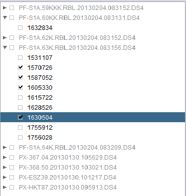

Re: Tree Box [message #1015392 is a reply to message #1015374] Thu, 28 February 2013 08:18 Go to previous messageGo to next message
Thank you for all information.
Now I have another question. I understand how I can retrieve all checked orders, but I need to find/retrieve only the selected node. Is this possible?
for example, in the following situation (see picture below), I want retrieve the information about the selected node 1630504.
index.php/fa/13606/0/
    (Size: 13.46KB, Downloaded 1053 times)
[Updated on: Thu, 28 February 2013 08:19] by Moderator
Re: Tree Box [message #1015395 is a reply to message #1015392] Thu, 28 February 2013 08:27 Go to previous messageGo to next message
We now speak from the selection (independently from checked/unchecked):
how about:
getMyTreeBoxField().getTree().getSelectedNode()
[Updated on: Thu, 28 February 2013 08:27] by Moderator
