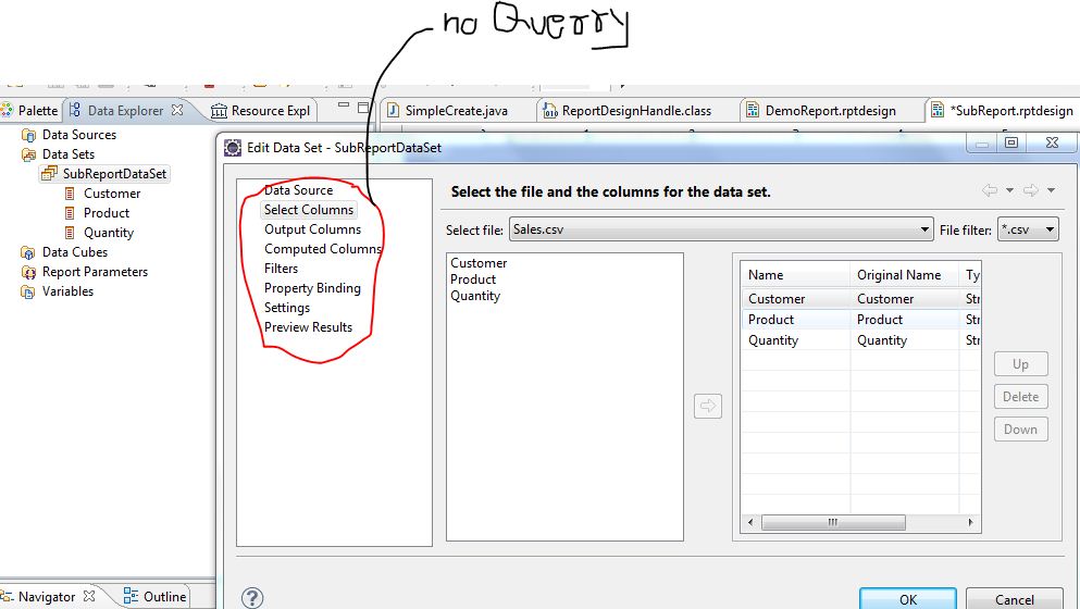

Query Option not displayed in Edit-DataSet Option [message #1014420] Mon, 25 February 2013 14:39 Go to next message
index.php/fa/13540/0/I am trying to create a sub-report using the Eclipse-BIRT, for that I have created a main report having a Pie-chart . After that I created one more report (with another Different 'Data Set') which I intend to open when a certain section of Pie-chart is clicked.
I am taking the Data from excel ( Customer.csv). It has three columns - Customer,Product , Quantity. The pie-chart of main report displays the Products and their quantity.Now on click of any section of this pie chart should open another pie chart of sub-report having names of the customers
I am not able to map these two reports one as the parent of another as - "QUERY" option is not displayed in the DataSet so I am not able to build SQL-Query to link them
Your help is much appreciated .
Re: Query Option not displayed in Edit-DataSet Option [message #1014644 is a reply to message #1014420] Tue, 26 February 2013 02:58 Go to previous messageGo to next message
With a CSV, you'll need to limit your data with a filter. You can use the value you pass from your main report in the filter to limit the values brought in. Let me know if I'm misunderstanding the issue.

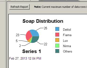

Thanks for your help. Now I am using AccessDataBase , I can build the Query now. I want to navigate on clicking a portion of SoapDistribution Pie-chart to display another pie chart showing its UserDistribution(Who uses that particular kind of soap for eg. If "Lux" is clicked than another pie chart should get open with the UserDistribution for Lux ).
My Questions are
1 - How to link these two pie chart ( Hyperlinking every section of piechart ?? if so how to do it)
2 - How to pass the value(name of particular Soap which is clicked in the pie-chart) from MainReport to another
So that i can build the query like
Select Customers from Sales where Product = someName ( that is passed from
MainReport)
Thanks in advance
Re: Query Option not displayed in Edit-DataSet Option [message #1015277 is a reply to message #1014983] Wed, 27 February 2013 21:30 Go to previous messageGo to next message
In the main report, you'd create your main query and create your pie chart, like normal. In the chart editor, you'd go to the format chart tab and add interactivity to your series to drill down to your detail report.
In your detail report, you need to make a report parameter to accept the value from the main report. Then, you'd make a query like: select customers from sales where product = ?
The '?' creates a dataSet parameter. In the dataSet editor, you'd go to the parameter section and double click on the automatically created parameter. In the link to drop down, select your already created report parameter.
Now, go back to your main report and go back into the drill down you created and pass the category value through the parameter to the detail report.
This should do it. Let me know if you have questions or if you get stuck because I missed a step.

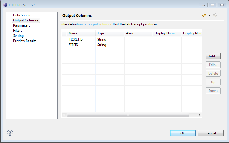

Re: Query Option not displayed in Edit-DataSet Option [message #1463300 is a reply to message #1017361] Thu, 06 November 2014 07:24 Go to previous messageGo to next message
Getting like this..
  • Attachment: Capture11.PNG
    (Size: 32.54KB, Downloaded 245 times)
[Updated on: Thu, 06 November 2014 23:46] by Moderator
Re: Query Option not displayed in Edit-DataSet Option [message #1464000 is a reply to message #1017361] Thu, 06 November 2014 23:43 Go to previous message
I also facing the same issue..not able to see Query option in Edit Data set.
Plz help me.
    (Size: 32.54KB, Downloaded 250 times)
[Updated on: Thu, 06 November 2014 23:47] by Moderator
