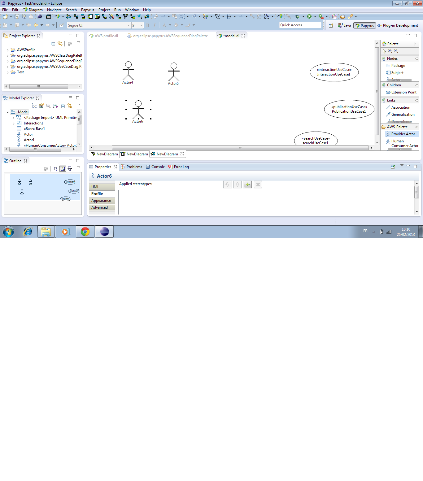

I changed the ID of the Editor (e.g org.eclipse.papyrus.UML.diagram.clazz) and it worked! Thank you
But something weard i've seen, i have a custom palette for the UseCase diagram, when i drag an stereotyped actor(because it's from my palette), the stereotype dosn't appear! It isn't even applied to the actor! (I checked "profile" in the property window!)
Here is a capture: index.php/fa/13549/0/
but it works normally with the use cases. Well, i'm surprised.
Do you have an explanation to that?

A few questions:
- Can you apply your profile manually and apply your stereotypes?
- Did you check the stereotype IDs/Qualified names in your palette definition?
Camille
Re: Papyrus Kepler version doesn't support Palette customization [message #1014743 is a reply to message #1014685] Tue, 26 February 2013 06:33 Go to previous messageGo to next message
- Yes i can apply the profile on the model and i can apply the stereotypes on Actors. But, even the stereotype is applied on an actor, nothing special happen! it's like i'm creating a normal Actor. I checked the "appearance" in the "apperance window", it's ok!
- I think nothing is wrong with the palette XML file, it's attached.
Don't forget that it works for the use cases, the sterotype is automatically applied when i drag a use case from my palette.
icon5.gif  Re: Papyrus Kepler version doesn't support Palette customization [message #1028636 is a reply to message #1014685] Thu, 28 March 2013 10:36 Go to previous message
Well I can apply a stereotype on an actor and the stereotype was shown when i changed the Display place from "Compartment" to "With Brace". But what I didn't understand is:
Why a stereotype(for an Actor) can't be automatically applied on an actor when i drag it from my palette?! And at the same time, a stereotype (for a Use Case) can be applied automatically on a Use Case when i drag it from my Palette!!?
The automatic application of a stereotype works for use cases, classes, life lines,.. but not for Actors! That's really weard.
