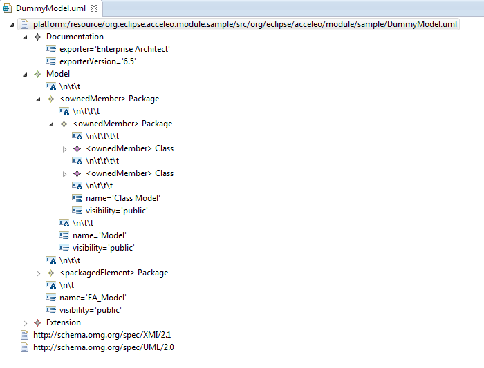

I can open the file with the UML Model Editor:
index.php/fa/13526/0/
The files 'DummyEA.uml' and 'DummyModel.uml' are the .xmi that I've exported from Enterprise Architect, while 'MyDummy.uml' was created in Eclipse:
index.php/fa/13527/0/

Re: [Acceleo] Use Enterprise Architect models with Acceleo [message #1013389 is a reply to message #1013381] Sat, 23 February 2013 09:52 Go to previous messageGo to next message
That doesn't look like a successfully opened UML model.
It is full of text annotations.
It looks like it's fallen back to reflective XML.
Use the declarations in MyDummy.uml to fix up DummyModel.uml using a
text editor.
Ed Willink

Re: [Acceleo] Use Enterprise Architect models with Acceleo [message #1023908 is a reply to message #1012086] Mon, 25 March 2013 08:46 Go to previous messageGo to next message
Hello together,
I seem to have the same problem as André. Unfortunately, I do not have the option to fall back to a proprietary solution.
Am not a XML expert, but it seems to me as if the UML models that are created within EMF are not stored in any standard XMI format.
So I assume, it would not be so hard to write a XSLT transformation from the XMI exported by Enterprise Architect to the XML format expected by Acceleo/EMF - unless I knew the expected format. Is there a schema definition available? I searched quite long for it, but without success.
An alternative might be to write my own model importer, similar to the Rose Model importer, but I guess, my problems won't get easier with that approach.
Any help is greatly appreciated.
@André: nevertheless, it would be interesting, how your experience is with YAKINDU EA-UML-Bridge. Any success with that?
Best Regards,
Christine
Re: [Acceleo] Use Enterprise Architect models with Acceleo [message #1027940 is a reply to message #1023908] Wed, 27 March 2013 12:18 Go to previous messageGo to next message
Hi Christine,
I postponed the integration with EA.
For now, I'm using Papyrus Diagrams to develop my project, but in the near future I would like to support XMI.
Re: [Acceleo] Use Enterprise Architect models with Acceleo [message #1066978 is a reply to message #1027940] Fri, 05 July 2013 06:26 Go to previous messageGo to next message
For those who could be interested, I've tested a trial version of YAKINDU EA-UML-Bridge with success. I was able to open and edit EA models in Eclipse.
Re: [Acceleo] Use Enterprise Architect models with Acceleo [message #1436707 is a reply to message #1012086] Fri, 03 October 2014 05:34 Go to previous message
I use Eclipse Luna and Acceleo 3.5. Acceleo is compatible with Enterprise Archiect (It's write on web site). I don't understand why we have a lot of difficulties to use EA with Acceleo. What is the procedure recommended by Acceleo to use Enterprise Architect. It is really compatible.
