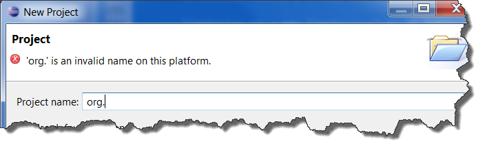

  • To simplify and promote an interactive GUI validation
  • To have dialogs or forms similar capable to provide messages as the attached screenshot.

For example, the setErrorStatus() method affecting the PROP_ERROR_STATUS property. Does form registers a listener on fields, and if yes, do you know a proper hook for that mechanism?
Just i thought to ask if there is already implemented something similar to FormData validation for the GUI, before i start the implementation of my own framewrok. I have already started implementing a validation framework using the hamcrest library, and if hopefully have any interesting result, i will share it with you.

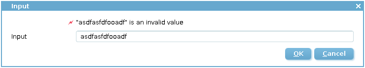

You can achieve a similar effect with a separate label field which displays the error message combined with a string field in "validate on any key" mode.
index.php/fa/13648/0/
Code sample:
  @Order(10.0)
  public class MainBox extends AbstractGroupBox {
    @Order(10.0)
    public class GroupBox extends AbstractGroupBox {
      @Order(10.0)
      public class StatusField extends AbstractLabelField {
        protected int getConfiguredGridW() {
          return 2;
      @Order(20.0)
      public class InputField extends AbstractStringField {
        protected String getConfiguredLabel() {
          return TEXTS.get("Input");
          return 2;
        protected boolean getConfiguredValidateOnAnyKey() {
          return true;
        protected String execValidateValue(String rawValue) throws ProcessingException {
          if (StringUtility.hasText(rawValue) && rawValue.contains("foo")) {
            String errorText = TEXTS.get("InvalidValueMessageX", rawValue);
            getStatusField().setValue(errorText);
            getStatusField().setErrorStatus(errorText);
          else {
            getStatusField().setValue(null);
            getStatusField().clearErrorStatus();
          return rawValue;
  • Attachment: InputForm.png

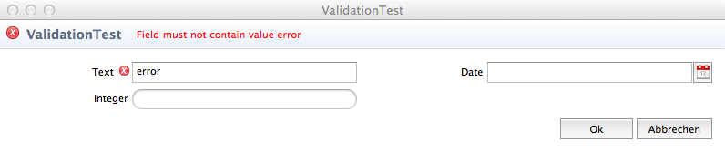

If you use the swt ui, you could use the eclipse forms IMessageManager instead of a label.
The advantage is: It looks good, it automatically handles stacking of multiple validation errors and you don't have to put it on every form by yourself.
index.php/fa/13649/0/
To make this work you need to implement some gui specific code. See the following code as example.

To make the header visible, you need to set a text on the eclipse form which can be done by setting a subtitle ond the model form (see SwtScoutForm#setTitleFromScout()).
public class ValidationTestForm extends AbstractForm {
  public ValidationTestForm() throws ProcessingException {
    super();
  protected String getConfiguredSubTitle() {
    return TEXTS.get("ValidationTest");
  protected String getConfiguredTitle() {
  @Order(10.0)
    @Order(10.0)
    public class TextField extends AbstractTextField {
        return TEXTS.get("Text");
        if ("error".equals(rawValue)) {
          throw new VetoException("Field must not contain value error");
        return null;
Have fun Smile
