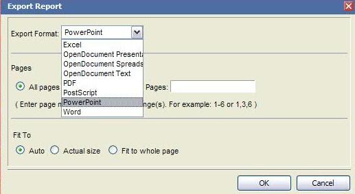

Re: BIRT ppt report with Office 2010 [message #1018466 is a reply to message #1014943] Wed, 13 March 2013 17:45 Go to previous messageGo to next message
Hi Michael,
Any update? My client has been asking the same question again and again; however, I can't tell them if this will be supported.
I found this link and it looks like there is a way to specify the version of the ppt: http://www.birt-exchange.com/be/documentation/ihub2/aic/help/brs/birt-reports/wwhelp/wwhimpl/common/html/wwhelp.htm#href=Exporting-IV.06.16.html&single=true
I'm using BIRT 4.2.2 and this is what I saw when I opened the viewer (Please refer to the screen shot in attachment). I didn't see the option to specify the version. Please advise.
regards,
Neil

Re: BIRT ppt report with Office 2010 [message #1019394 is a reply to message #1018466] Fri, 15 March 2013 11:40 Go to previous messageGo to next message
That page you linked to is for the commercial line of BIRT. The PMC is currently in the process of getting a pptx emitter into the open-source product. Hopefully it'll make it into the next version. The project plan for the next release should come out soon. We should know if it made the cut then.
