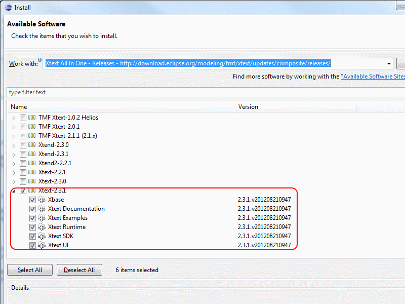

Hi Dennis,
Dennis Huebner wrote on Mon, 11 February 2013 08:06
what do you mean with "the normal XText feature"?
i mean the red boxed feature i've selected in the new software dialog. If the bundle "org.eclipse.emf.mwe2.launch" is requird by XText to launch mwe2 it should be included!

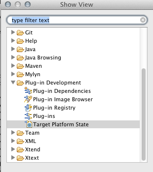

Re: Unable to launch mwe2 workflow [message #1008375 is a reply to message #1008209] Tue, 12 February 2013 03:34 Go to previous messageGo to next message
Also check your active target platform. Use "Target Platform State" view.
index.php/fa/13375/0/
