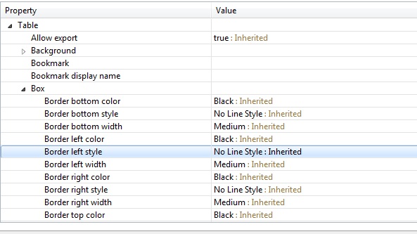

Have an EMF RCP app that allows the user to create their own global properties (meta-type). Want the view behaviour to break the default behaviour of being shown in the treeview and shown in the properties view. There is a similar-ish case where we have done this (using the good EMF book) but this is when there was just a one to one containment relationship between the two EClasses. This new behaviour we want to allow the user to define many global properties and for these to be catgegorized as a global property.
The attached pic is an example (although not exact) of the view we would like to do.
Are current thinking is that we would have to create our own custom properties view. If this is correct is this a big undertaking? Any tips on things that should considered when doing this?
Any help appreciated

To explain the attachement better...."Table" would be Global Property and then ignore the other lines apart from "Background" and "Box" which would be an example of a user defined global property..... The EAttribute for each global property is the same for each GlobalProperty

If I understand correctly from your last diagram, it's a matter of
ensuring that getPropertyDescriptor for your ModelItemProvider returns
the set of all properties you want at the top level in the properties
view. I'd suggest having a look at
org.eclipse.emf.edit.tree.provider.TreeNodeItemProvider.getPropertyDescriptors(Object).
In this case it's showing how to merge the property descriptors provided
by the object referenced by a tree node as if they are properties of the
tree node itself. That type of approach should work for your example.
