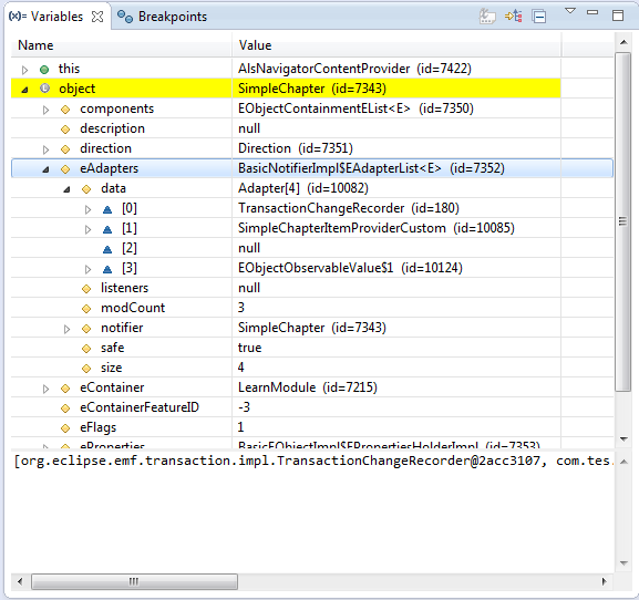

I use Common Navigator Framework for represent my model, but sometime (don't understand a reason) one of eAdapters becomes to null. And when I try to add some child to this element I have an exeption.
Can anybody explain me the reason and how to avoid it?

This is always caused by multiple threads adding adapters at the same
time, corrupting the list of adapters. In general, EObjects are not
thread safe, particularly not for multiple writers.

Ed, thanks for reply.
But how I can fix it? I haven't my own adapters, all adapters added from another plugins.. Is only solution is fix their sources?
Thanks, and
sorry for my english)
Re: eAdapter is null [message #1008985 is a reply to message #1008974] Thu, 14 February 2013 03:50 Go to previous message
Dmitriy,
If the code adding the adapters needs to be fixed where ever it may be.
It might well be the case that your code is doing things in some thread
that's causing adapters to be added in your thread. I know nothing
about the specifics of the common navigator framework, so I can't help
track down such a problem...
