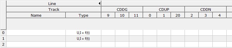

I have to create a table with 3 rows in the column header. Plus having a ColumnGroupHeaderLayer and
ColumnGroupGroupHeaderLayer.
I imagine the ColumnHeaderLayer shall display 3 rows.
What I did so far:
I implement a ColHeaderDataProvider and getRowCount() return 3.
See the attached picture for the result.
Unfortunately it is still only one row in the column header but not 3.
How to implement the desired behavior?
Martin

Re: column header with multiple rows [message #1008069 is a reply to message #1008050] Fri, 08 February 2013 12:31 Go to previous messageGo to next message
The grouping is OK in row 0 and 1 of the column header.
Row 2 of the column header is also OK (Name, Type, 9,10,11,0,1,.....)
Furthermore I want a row 3 and 4 of the column header without grouping, just like in row 2 of the
column header.

Does your IDataProvider provide data for those 2 additional rows? In terms of height it seems to interpret the 3 rows correctly.
Re: column header with multiple rows [message #1008372 is a reply to message #1008161] Tue, 12 February 2013 03:13 Go to previous messageGo to next message
Thanks Dirk,
Yes the data provider provides data for all 3 rows but only row 0 get called. May be there is an
error in ColumnHeaderLayerStack?

Seems to be a bug in the ColumnGroupHeaderLayer and ColumnGroupGroupHeaderLayer. The spanning of cells seems to be calculated wrong. Please open a bug for this.
Re: column header with multiple rows [message #1008398 is a reply to message #1008384] Tue, 12 February 2013 05:24 Go to previous message
added: https://bugs.eclipse.org/bugs/show_bug.cgi?id=400548
