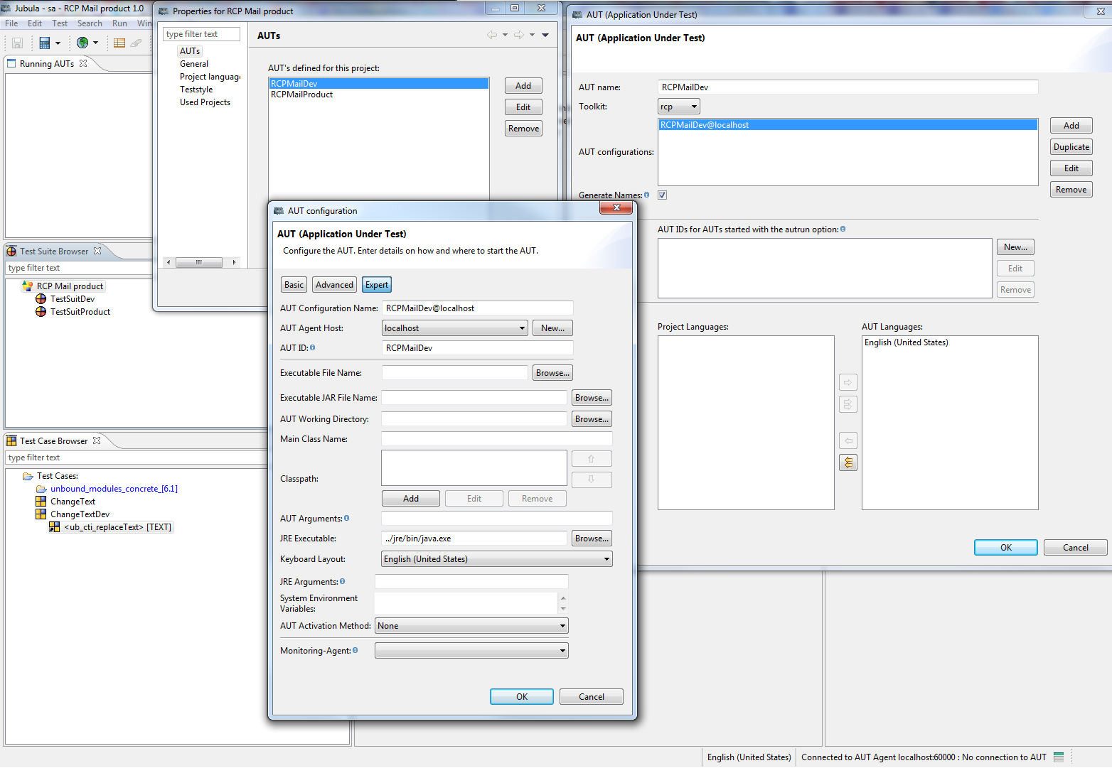

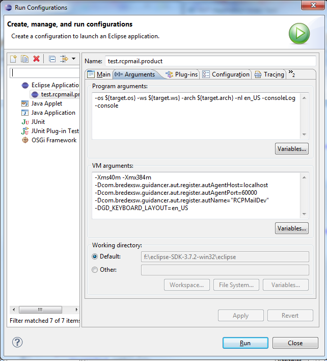

Hi Alex,
Thank you very much for your help.
Sorry for the missing info. I use everything locally. From Windows I removed all the keyboards except the en_US so this is the only keyboard I can use (just to reduce the possible problems).
I tried it with the RCP Mail example in Eclipse.
The test wants to change the content of the "Message" view with a new text.
When I exported the RCP Mail to an exe. I found that the replace text worked fine.
The problem happens when I want to test the RCP Mail in development mode. Here are the pictures of the settings:
index.php/fa/13390/0/
index.php/fa/13391/0/
And here is a short video how I started it: www.youtube.com/watch?v=ZR7ZdR_H8uA&feature=youtu.be
In the video it is visible that the test found the Text widget in the "Message" view and selected the the whole text but the replace was not performed.
My goal was to test the RCP during development time before sending the new changes into the repository. Unfortunately I have no chance to export the project into product exe.
Gabor
