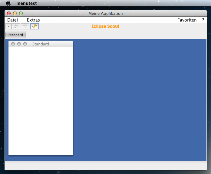

Hi, i have some menus that are ok when starting the client from inside Eclipse:
index.php/fa/13279/0/

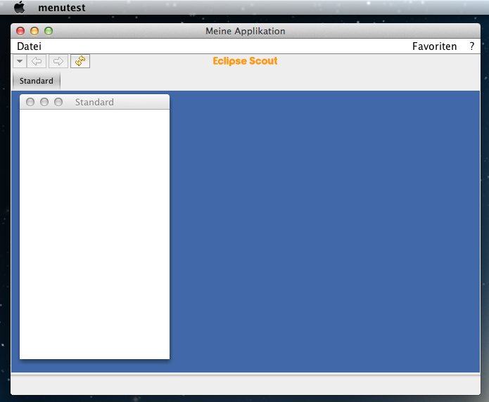

But when I export the RCP app (using Eclipse Export Menu) the menues are gone:
index.php/fa/13280/0/

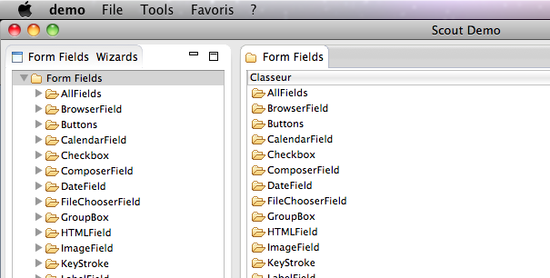

I have tried on a different config and I am not able to reproduce this bug.
In both cases I got the menu:
index.php/fa/13306/0/
Mac OS X: 10.6
Java: 1.6
Scout version: 3.8.1
Eclipse: 4.2.1

Menu inside Swing Frame:
index.php/fa/13320/0/
"Extras" Menu disappears:
index.php/fa/13321/0/

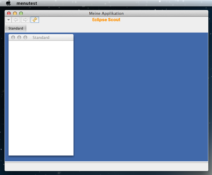

I can reproduce the following:
* The menu bar does not properly in the exported product (swing)
* An empty menu (Tools for me) disappears in a certain case: If i click on "File", and try to move the selection with released cursor over to the 'Tools menu'. (Instead of the blue background of the 'hover/selected' state, the menu title disappears)
