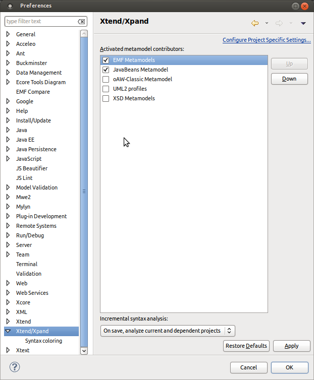

After reimport I could fix some other things with:
-define a Tomcat 7 runtime
-build a usefull target platform
But now I have the next problems:
The first one is realy small:
Inside: org.eclipse.emf.texo.demo
It missed the class: Asdad
The bigger problem:
At the xpand files inside
Plugin: org.eclipse.emf.texo.modelgenerator
Package: org.eclipse.emf.texo.modelgenerator.templates
I've got warnings and errors like
Warning markers for the imports
Namespace org::eclipse::emf::texo::modelgenerator::modelannotations» is
unknown or unused
errors:
Couldn't find EClassModelGenAnnotation addition.xpt
/org.eclipse.emf.texo.modelgenerator/src/org/eclipse/emf/texo/modelgenerator/templates
line: 9 Xtend/Xpand Problem
Couldn't find EPackageModelGenAnnotation addition.xpt
line: 5 Xtend/Xpand Problem
What I have to do, to fix these errors?
Thanks again
Heiko
PS: I'm new at xtend/xpand. ;)

Hi Heiko,
For getting rid of the errors you can set the preferences as in the attachment. But I did it differently, I set these
preferences at project level now (so they are now in the git repo).
I also solved the demo project issues. Note the demo project is mainly used by myself internally for testing manual code
generation through the ui. But there should not be compile errors in git ofcourse.
Note that texo currently uses xtend templates only, but uses xpand for extensions/overrides. The xpand templates in the
plugin are there just as an example. This page gives more details:
http://wiki.eclipse.org/Texo/Template_Overriding
gr. Martin
